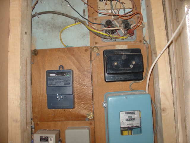

A friend bought a house in France and asked me a few questions I couldn't immediately answer.
I'm sure those are the same posts that are used on the back of my hifi speakers.. hang on a minute.. yes they are!
There are four speaker posts, one for each phase and I assume the red one's neutral, which I assume goes to a rod outside?
When the speaker posts proved inadequate a distribution board was added. I would replace the three speaker posts with three CUs; making it easier to balance the phases for one.

That must be a very old CU, for a rural installation too i bet!! It's the smallest i've seen in France!! These day's they would be at least 3 X the size of that one, and that would be a small one...lol!! Now they fit everything into there DB'S timers, ELV TX's, SW/relay's, ...the whole nine yards go in them now....lol!!
The TV signal/Router/AV also has to be distributed from here I hear, if you want to get the work signed off. Altho my friend is looking to retire here, so a) the roof etc only has to last twenty years b) selling will be someone else's problem.
My understanding is their new DBs use double pole circuit breakers (handy on a RCD board when you have a neutral to earth fault) also 2 way switching forget it they have a latch module fitted at the DB and they wire the lights off it and pulse switches ie switch down and spring return so you can fit as many swithes as you like ie no intermediate. Also if new build or update you run the cables in white flexi conduit so 30 years down the road its a scooosh to rewire. Old elctrics wel they have some properties in the same state as ours just seen a property in the new town (Edinburgh) and it had the original 1920 doble pole fuseboard plus VIR cables to boot. One other thing is about 10 years ago France still had duel voltage supplies in some areas ie 110v and 230v How do I know this Well looked into getting a property 10years ago and spoke to a guy who lives over their last week
Spot on oldtimer!! Though generally the DP breakers are on TT systems, of which there are a great deal of in France. They also use a fair bit of neutral switching on control circuits, which is a bit strange...lol!!
I like their pulse on pulse off idea. They insist on Radials with 8 sockets per Radial and insist on singles pulled through Gaines - now that sounds like a right Ball Ache to me. There are four bedrooms, so that's four Radials plus lghting going downstairs.. Here's an idea.. What about a DB at the top of the stairs and

The kitchen will have to be balanced across three phases so I guess a fistful of cables WILL HAVE to be run from the kitchen to the CU.. Then again the DB in pic 4 is three phase - in pic 2 you can see a large grey cable wired into all three speaker posts & N - that's the cable which runs to the DB @ the bottom of the stairs in pic 4.
What are the merits/pitfuls of having fuseboxes spread around, or is it better to shove it all in "one fusebox under the stairs"?

I've not heard about tv boosters and routers etc, being incorporated in the DB's before, are you sure about that?? I can foresee some very real problems with signal interference/degradation if there not in a screened off area of a common multi phase DB unit!!
Not sure about twin DB's, but that's a common occurance in Cyprus, i have a CU on my landing upstairs that caters for all the upstairs room installations, and like your situation, my supply is 3 phase too!! I personally don't like it, and was more than a little pi***ed off when i saw it. As this is France, lol!! do it the way which is easier for you!!
As far as i know, you can use there circular multi core building cables for your install, that incorporates 3/4 /5 (with full sized CPC) solid core conductors. you can't use our T&E type cables, that is a very big no, no!! lol!!
I'd be very careful mind, they have some very Draconian rules about who can and can't house wire. So do a bit of investigation on that score before you start anything. As they WILL demand you pull it all out if you contravene any of there rules or regulations

I'm mystified at how the previous owner was able to sell it. Did you see the line of choccy boxes above the speaker posts in pic 2?
The 3 phase cable going to the DB in pic 4 has been cut in two and a choccy box inserted, a wire from a large HWC has then been inserted into 'said choccy box. The choccy box is pinned to the wall, as the wire is.
You can see another wire cut into with a choccy box in pic3 top left...
