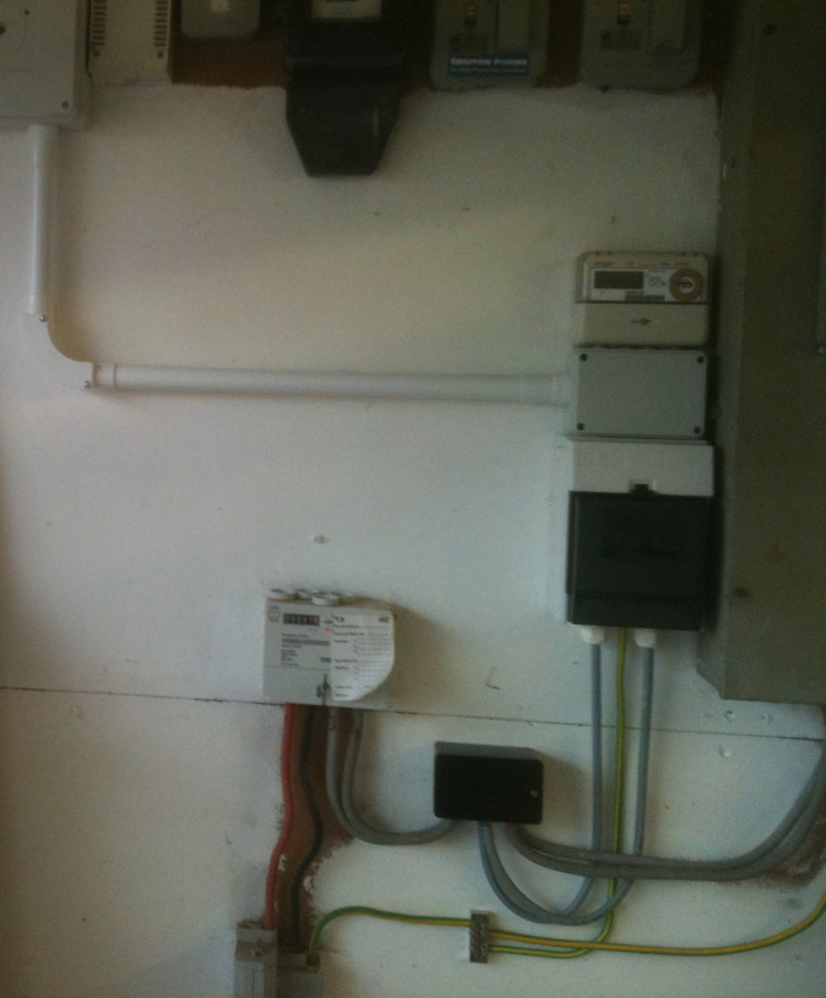

here's one I did earlier!View attachment 12609 Not the best I've ever done but the only photie I've got to hand.
labels went on later before anyone comments!
Middle set of tails go to dedicated CU. Right hand tails (as we look at it) go to main CU
Moggy, make sure you don't strip the outer sheath of the tails outside of the henley block otherwise you have a single insulated conductor with no mechanical protection outside of an enclosure which would warrant a defect code on an EICR.

good pic! tails are undersized for 100amp suppliers fuse
The 20A MCB within the 2 way consumer unit would provide overload protection for the 16mm2 tails so not an issue though connecting before the suppliers meter is a serious no-no!
My 2 way solar CU is supplied with 10mm2 tails and that's not an issue either.
Absolute shocking job though. I'm just amazed somebody could actually carry out an installation like that and not give it a second thought :(
I think I have spotted another fault here chaps, they have brought the Earth in from the array, so bringing a potential into the equipmental zone, it should be on its own Earth spike, unless there are velux windows of course, which I doubt. Your thoughts?
I did not spot the RCD though, sorry.
All looks like cheap tat as well, probably won't last more than a few years!
Think that's the roughest solar electrical install i've seen, I wonder what the roof work is like...

It's always been the case that you can't have a single insulated conductor outside of an enclosure or containment but you're right, there's many installs out there with that issue and the DNO are more guilty than most, especially with their meter terminations. Maybe that's where the habit has come from?
If you're carrying out an EICR then just report and code them appropriately. No need to make any changes there and then, only if the customer chooses to have the defects rectified though the meter terminations are obviously the DNO's responsibility. You can still note them on your EICR though.

I think tails are undersized for 100 amp suppliers fuse
If there's a 20A MCB in the 2 way CU then how can the tails be subjected to an overload greater than the rating of the MCB?
In other words, the MCB is your overload protection and the tails are fine.
Think of an 800A busbar chamber with a few 32A switch fuse isolators fed from it. Would you expect conductors rated at 800A to be terminated into the 32A switch fuse?
If the RCD short circuited then the prospective fault current could be thousands of Amps.
Agree to a point about a busbar chamber but the small tails would or should be mechanically protected.
They are mechanically protected - by their outer sheath. No other protection needed, subject to environment.
Many thousands of amps would be great for fast breaking of a protective device that's suitably rated to break the fault current without destroying itself.
