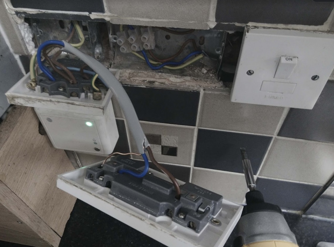

Hi, quick posting - welcome any advice as new to this stuff...
Have a Howden HJA 0150 gas grill/oven with a broken thermostat that and can't get a replacement (grill igniting but no gas coming out of oven burners when on).
The Howden grill/oven is on a ring in the kitchen which has following appliances on it:
-microwave
-fridge freezer
-kettle
-toaster
-a Howden gas hob
-the busted Howden grill/oven
-couple of kitchen sockets generally not used
It all goes back to a RCD with a fuse that says - MTN132 b32 hanger fuse
There is an electrical wall connection for the grill/oven, with (I think) a 6mm wire for the ring (and not the thicker 10mm wires used for showers).
I may want to replace with just an electrical gill/oven. So some questions...
-Is there is max kilowatt oven that I could just wire into the current wall socket (which is used for the current grill/oven electrical ignition connection)?
-Would I need to replace the fuse in the RCD for the main? And is so with what?
-Would these things ensure the fuse would not trip if the oven was switched on?
-There are lots of electrical ovens but the instructions say they should be wired directly to the fuse box, so wondering if there is one which can just run from this ring main (if I upgrade the fuse)?
Would hate to buy an electrical oven and then its a nightmare and expense to fit it (the fuse box is currently full).
Welcome advice.
(attached pic of gas connection, and wall sockets for hob and grill/oven)

Yep. Fine. Leave as it is protecting the circuit.
Yes, plug in one seems fine - had to check as even if its plug in, was worried it could keep tripping the fuse if someone decided to make a cuppa and toast whilst chips were in the oven and warming some milk in the microwave. with phone recharging in plug.
If you turn all those on, I would wager the MCB won't trip, unless you buy an unusually powerful oven.
Search results for "plug in ovens" | ao.com - https://ao.com/l/search/101/99/?search=plug%20in%20ovens
...looks like there are options and hopefully they don't have any small print saying it needs its own line to the fuse box.
The first 'recommended' one at the top of that list is 2.8kW, so that's pushing it. Go for 2.2kW max.
You obviously need to pick one the right physical size to fit your cabinet!
If they come with a plug, no small print. I suggest keeping the plug on it and having an electrician fit a decent socket in place of that FCU.
Just didn't know if anyone else was in this position and had a recommendation for an oven that goes in no hassle for reasonable price?
I can't tell you which oven you would like! Research them on the basis of physical size, power consumption (2.2kW or under), reviews, maybe customer satisfaction ratings if you think you can trust them!
I assume its a case of stripping plug so its fit it into the FCU.
See above. Don't cut the plug off (cue debate about invalidating warranty, not). Plug it in.
I would need someone to cap off and cert the gas supply I guess?
Yes. And preferably someone to fit a good quality 13A socket in place of the FCU.

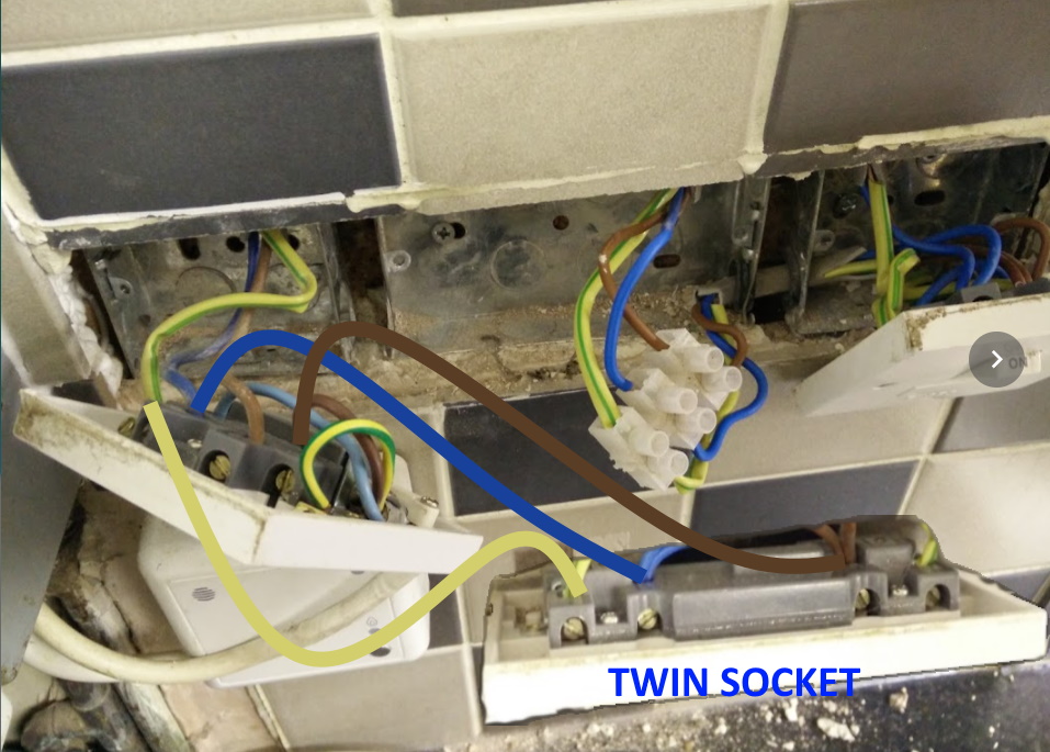

If an electrician was designing your kitchen circuit knowing what we now know, he would provide 2 rings, or at least a separate cooker feed.
If it were my house, and I was living there, I confess I would probably put the cooker on the ring, and use the knowledge that it's not wise to run everything at once. But I'm not suggesting you do that 🤭
With others living there, particularly if elderly or vulnerable, needs to be handled properly. Back to gas or a separate circuit?
Afterthought - is there by any chance an adjacent room with another ring, the other side of a kitchen wall? Was just thinking a spur off a different circuit could feed say the washer, alleviating the load on the kitchen circuit, so you could possibly proceed as before 🤪

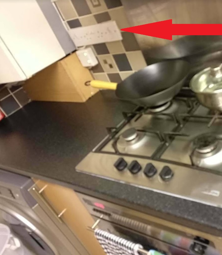

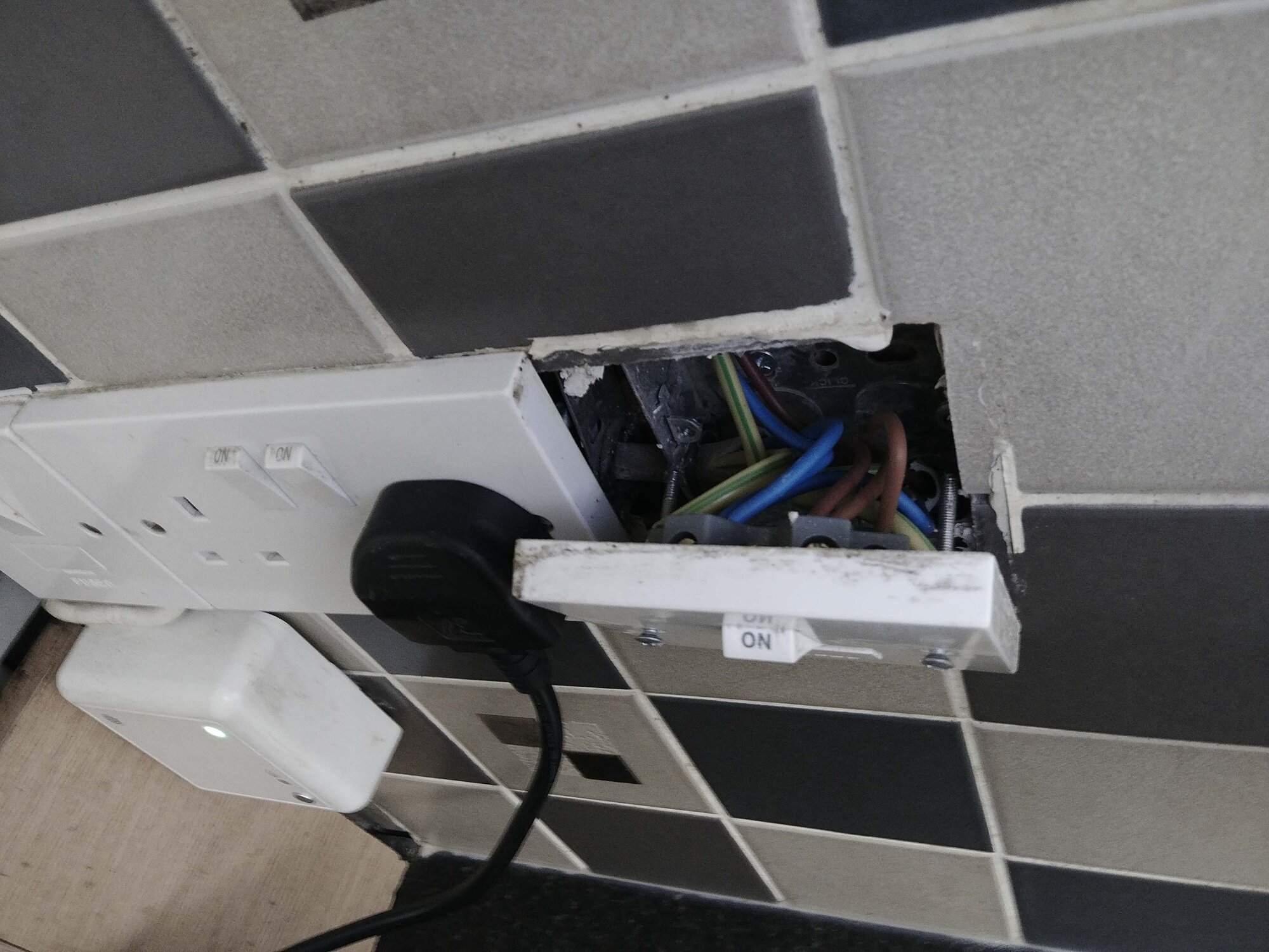

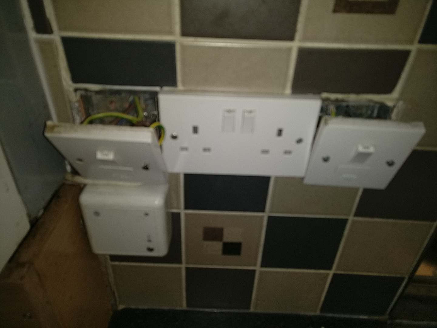

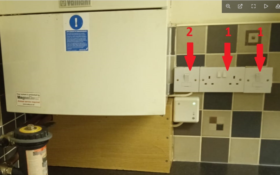

Actually, above the washing machine there is a gas boiler (Vailant Turbomax VUW 282 E – 28KW), on a separate circuit shared with a hive system and a couple of sockets next to it which goes to a Hager 20A fuse (pics attached). I assume a gas boiler does not have much elecy draw? Would it be relatively easy to get the washing machine wired into that system/spur if it trips the main ring circuit?

Gosh, there is not much chance of a dedicated wire as no slots on the fuse board even if I could run a dedicated cable to the board.
Possibly a 20A radial which it would be good to get confirmed by an electrician.

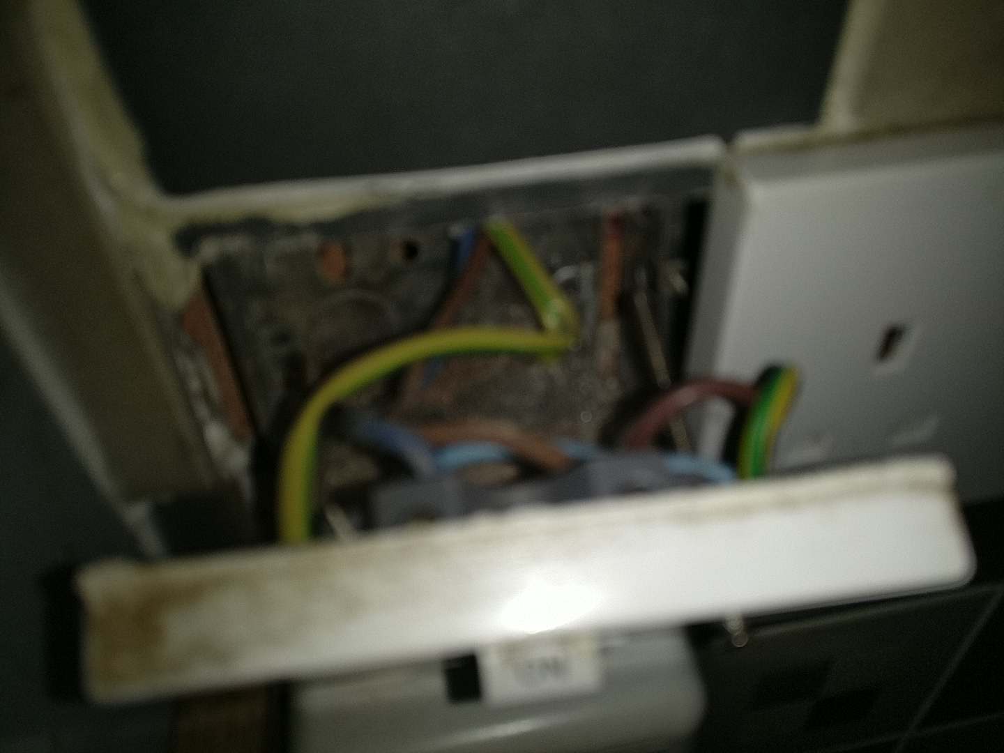

I did take a look at the washing machine/boiler wiring arrangement, pics attached...
1- Washing machine pulled out
2- Wall switch to power socket for washing machine
3- Single plug socket in underneath area for washing machine
4- Wiring access around the boiler
I assume the best way is to get an elecy to run a cable down from that double plug next to the boiler down to the fuse spur for the oven? (which is under the kitchen top and behind the oven)
Is it that straightforward to wire the oven into that boiler/washing machine 20A ring?

If you are contemplating making any changes to the fixed wiring, I feel it's essential you get an electrician to look at the options. You need to have it confirmed that our theories about the kitchen ring, and the boiler radial, are actually correct, and then the electrician can consider the wisdom and practicality of what you're suggesting.
I didn't intend to suggest putting the oven on the boiler circuit, I don't think that is a good idea.
If it were me, I would pass the flex of the washing machine up behind the worktop, probably in the boxing-in of the pipes, and plug it into the socket by the boiler. That would avoid the possibility of excessive load on the kitchen ring, so you could then wire the oven into the spur already provided for it. And thus no changes to the fixed wiring.
I didn't intend to suggest putting the oven on the boiler circuit, I don't think that is a good idea. If it were me, I would pass the flex of the washing machine up behind the worktop, probably in the boxing-in of the pipes, and plug it into the socket by the boiler. That would avoid the possibility of excessive load on the kitchen ring, so you could then wire the oven into the spur already provided for it. And thus no changes to the fixed wiring.
So, if the below is correct in the way its wired, you're suggesting plugging the Hotpoint Washer Dryer into the Kitchen Circuit 2 and then the New BEKO electrical oven would be okay on Kitchen Circuit 1?
