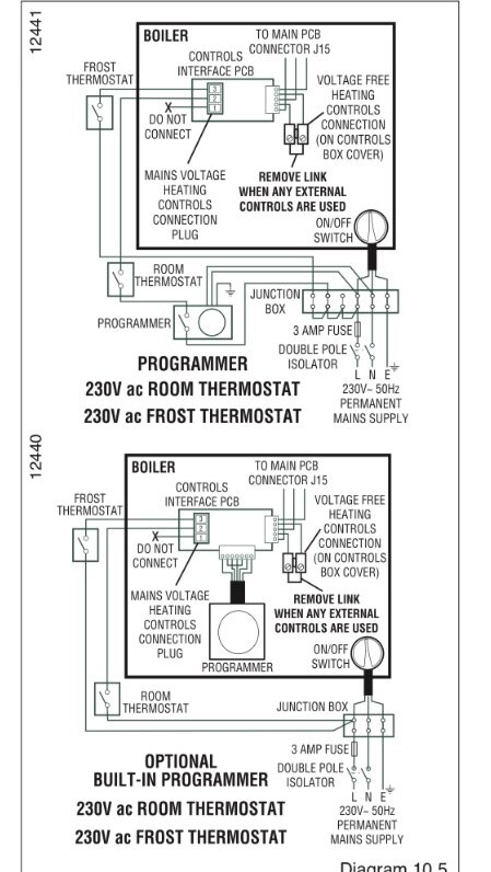

Hi ive not wired up many boilers before but am trying to learn at the minute as its one thing im really not sure about.
Im having issues wiring a glow worm 30 cxi to a Drayton rts8 thermostat. The boiler fires up when i link out the volt free terminals so i know the boiler is ok. But i cannot get it to fire up off of the thermostat.
At the moment there is a 3 core flex comming from the sfcu to the stat and then a 5 core from stat to boiler. The line and neutral from sfcu are in the terminals marked L and N in the stat and are commond up with Line and Neutral to the boiler in 5 core. The other two cores are to the volt free terminals at the boiler. This is the bit that im not sure of, it doesn't matter what combination i connect the volt free cores to it cant get the boiler to fire up off of the stat. Ive tried both in terminal marked 2,one in 2 and one in 3 . Both in 3. Ive seen on the instructions to put one core in the L and other in 2 and this hasnt worked either. As these are volt free terminnals im very weary and dont want to keep trying and create an issue.
Any help would be appreciated
The thermostat instructions say they are compatible with boilers with 24V to 230V switching and you are trying to connect it to a volt free contact in the boiler. You could try choc blocking the live and neutral connections through and connecting one side of the volt free contact to L in the thermostat and connecting the other side of the volt free contact to number 2 in the thermostat and see if it works. If it doesn't remove the link from the volt free contacts and connect the boiler up using the 230V switching terminal in the boiler. To do this you would have to put the live and neutral back in to the live and neutral terminals in the thermostat and connect number 3 to the 230V switching terminal/plug in the boiler. Page 27&28 of the manual

Thanks everone, all sorted. It was the line and neutral feed in and out that was the issuse as i was using the L and N terminals on the stat as feed in feed out terminals. Once they were nicely choc blocked up Like leesparkykent suggested i put one wire from the volt free terminals in L and the othet in 3 and job done fired up on the termostat.

I think it was too early yes I meant 3 not 2, but great I'll give that a whirl and thanks.
