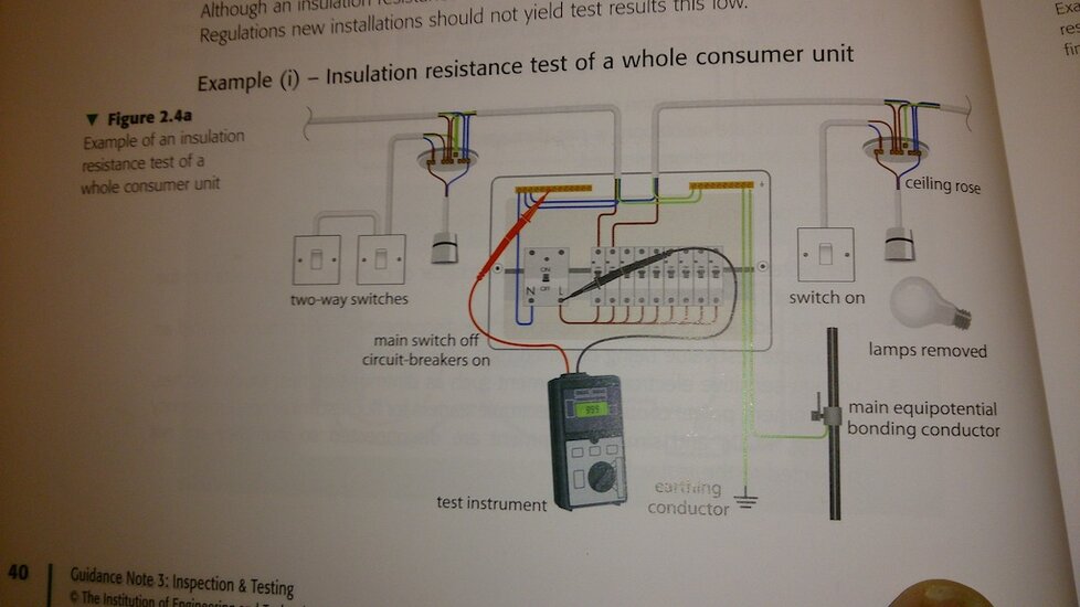

Someone tell me where I'm going wrong.
I'm reading up on testing theory, using GN3 (6th edition, incorporating Amd 1, 2012). Section 2.7.7, pp40-41.
"Simple installations that contain no dist. ccts should pref be tested as a whole, see fig 2.4a."
[ElectriciansForums.net] GN3: IR test, whole installation vs final circuit
"Test should be carried out with main switch off, all fuses in place, switches and cct breakers closed, lamps removed..." blah blah.
Got it. All good :)

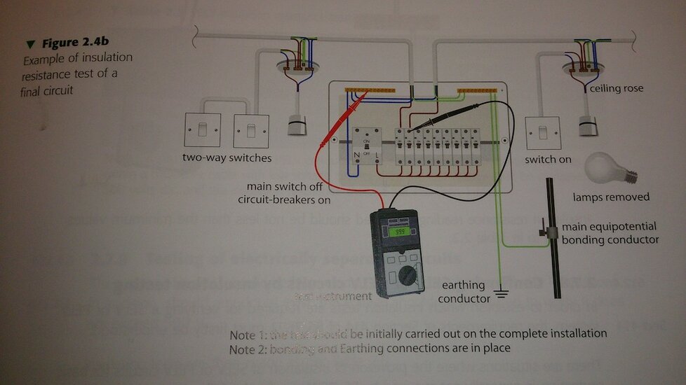

"Example (ii) - IR test of a final cct. Fig 2.4b shows an example of testing a single final circuit at a CU (only the line to neutral test is shown)."
Unlike the first example (fig 2.4a, for the whole installation) there is no accompanying text to say, "main switch like this, fuses like that or CBs like the other," all you've got to go on is the picture.
But all the breakers are set to "on". Which means, all your circuits will be in parallel, wont they (as far as an IR test is concerned)? And you're not doing an IR of just one circuit at all, you're doing the whole installation again. Aren't you? Should you, in fact, turn the breakers off / remove the fuses (to IR test individual circuits)?
Or am I going wrong somewhere?
looking at the 2 pics. the only difference is that the 2nd example is through the MCB so will also give a global reading. unless i'm missing something due to the beer.

yeah you are right the breakers are still on and the cable is terminated into the breaker so it would just do a global line to neutral again with the illustrations its basically the same test, it should show the breaker off or to take the cables out of the terminals and test it by its self (that's what i do when test one circuit). its definatly interesting haha
