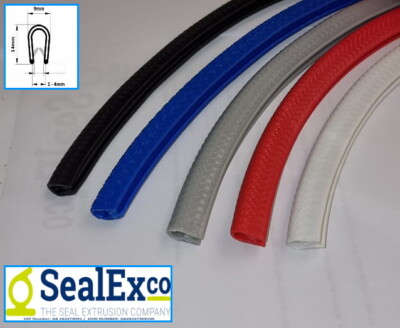

I’m looking for edge protection for a straight cut in steel trunking.
“Grommet strip” in a search on CEF only brings up the small, flexible stuff for round holes.
The stuff I’m thinking of is straight, not flexible… usually black, but would prefer white if I could get it… Covers about 10mm or more on each side of the metal.
Spent all weekend trying to think of the right words to use on an online search that isn’t “grommet strip”
Recommendations and links please

Thanks. That’s the small stuff I usually get from wholesalers for the back of boards etc. or the crenellated (?) type.
I’ve just seen this on eBay, which is more what I’m looking for.
Will have a good look tonight and buy it from there. Needing less than a metre really.

Can't recall where but I daresay google would reveal, I bought a roll of grommet strip that has pressure activated glue inside. Wasn't cheap but omg. If regulars all I have I just cover it with some 1" duct tape which some might sniff at but V.
If you google this
"car panel edge rubber cover strip"
You will find a variety of sizes which might do the job.
Theye usually have a much wider coverage.
Mitre Bond is your friend with these.
