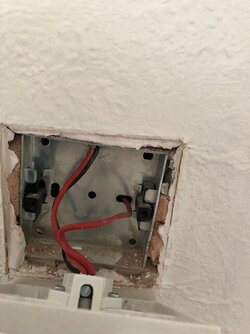

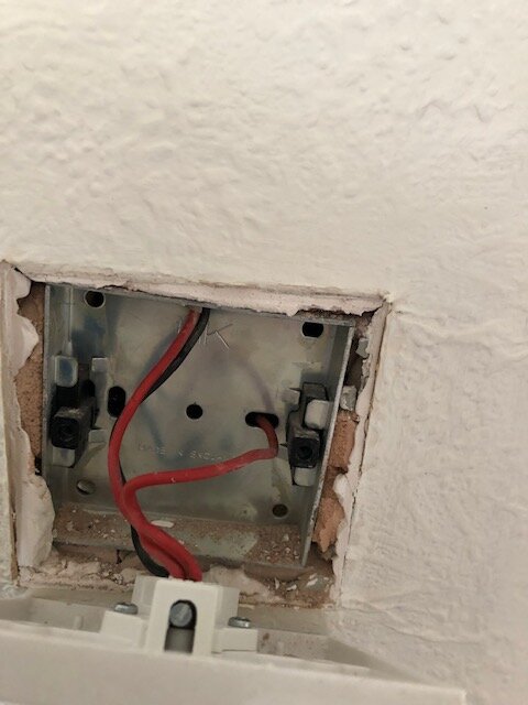

Whose to say the black cable wasn't 'nicked' whilst installing? ?
One side of wall......
[ElectriciansForums.net] grommets and earth Sleeving are so over rated
........going through to the other......
[ElectriciansForums.net] grommets and earth Sleeving are so over rated[ElectriciansForums.net] grommets and earth Sleeving are so over rated
  • [ElectriciansForums.net] grommets and earth Sleeving are so over rated

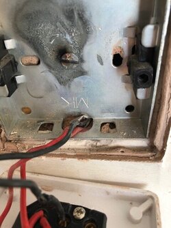

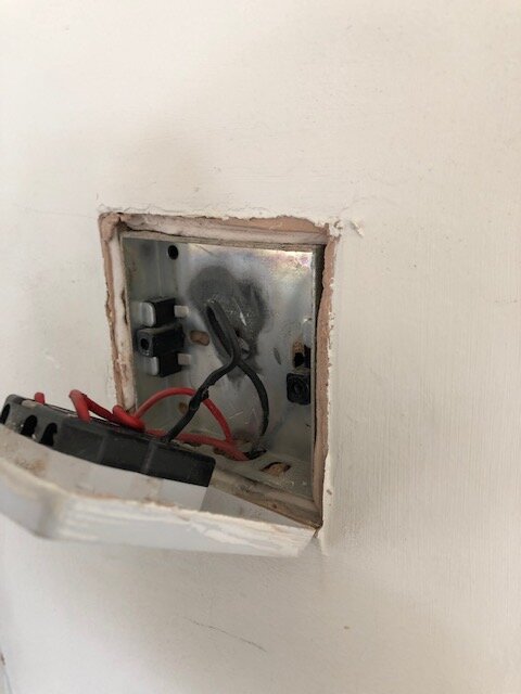

Come across it all too often.
“I was just doing a bit of decorating and unscrewed the switches from the wall… when I screwed them back, there was a bang!”
I remember that one as it was metal switches and no earth flylead. Could have been nasty.
Other time someone was decorating and was trimming the wallpaper behind a loosened switch with a butter knife…. Power was still on, and she touched the top terminal screw…. No more butter knife!
Off tangent a little. Apologies. Grommets and sleeving…. Yes to both, but understand plaster holding cable in place. Safer just to say grommet always.
I can appreciate that what I stated sounds like heresy to some. But I have never, ever seen a t&e cable damaged due to lack of a grommet. I have many times encountered problems resulting from unsleeved earth's and from live and neutral cores coming in to contact with the metal box for various reasons. Add to that the number of problems resulting from accessory screws nicking a live conductor. But problems resulting from lack of a grommet? Still have to experience that.
I have experienced it several times. The last one was a neutral core being pressed into the edge of the hole, causing the RCD to trip periodically.
