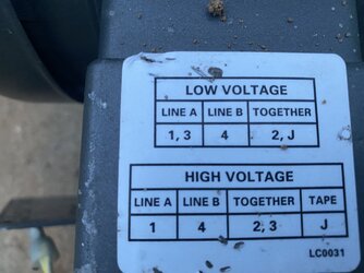

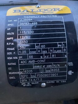

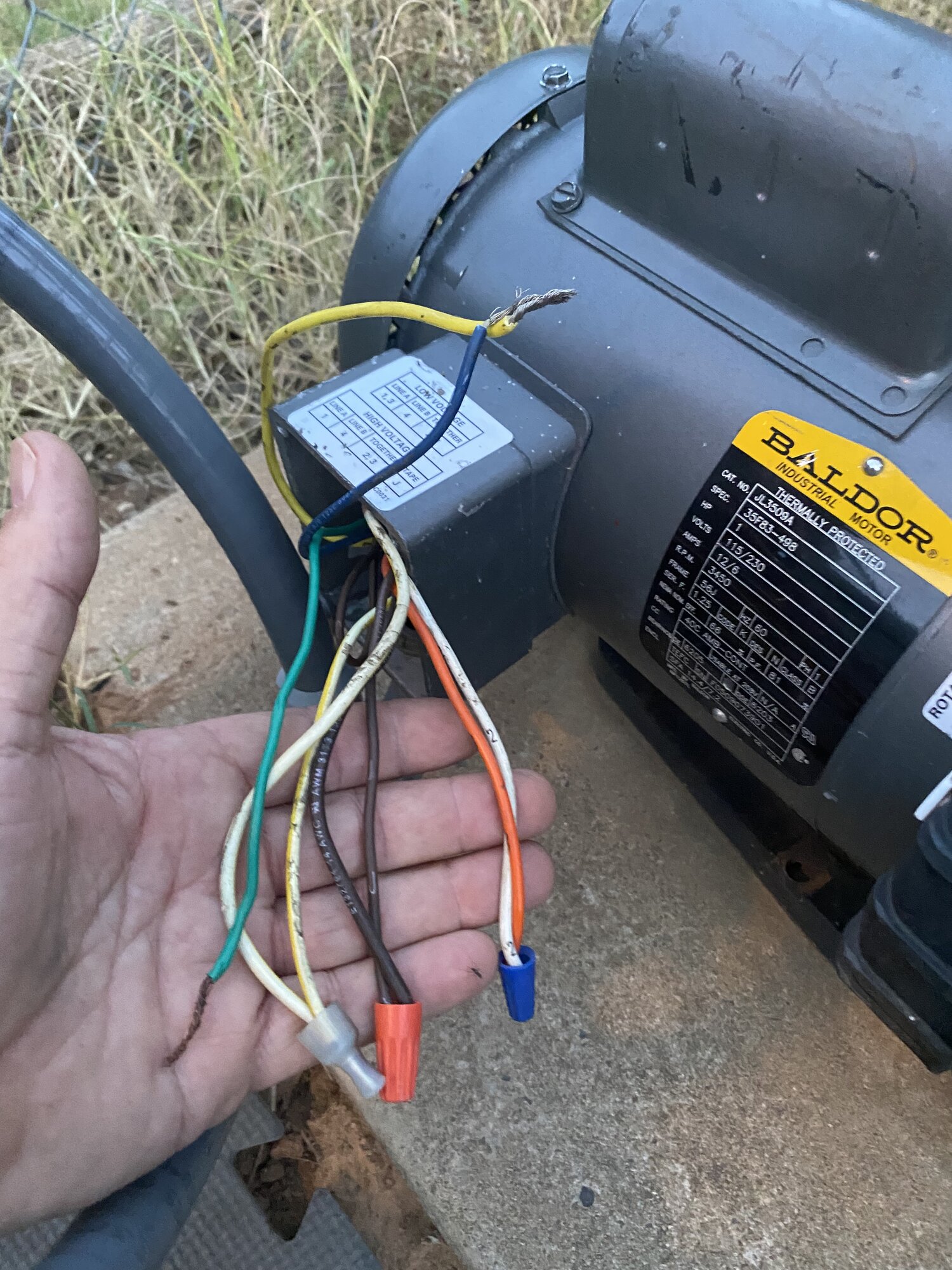

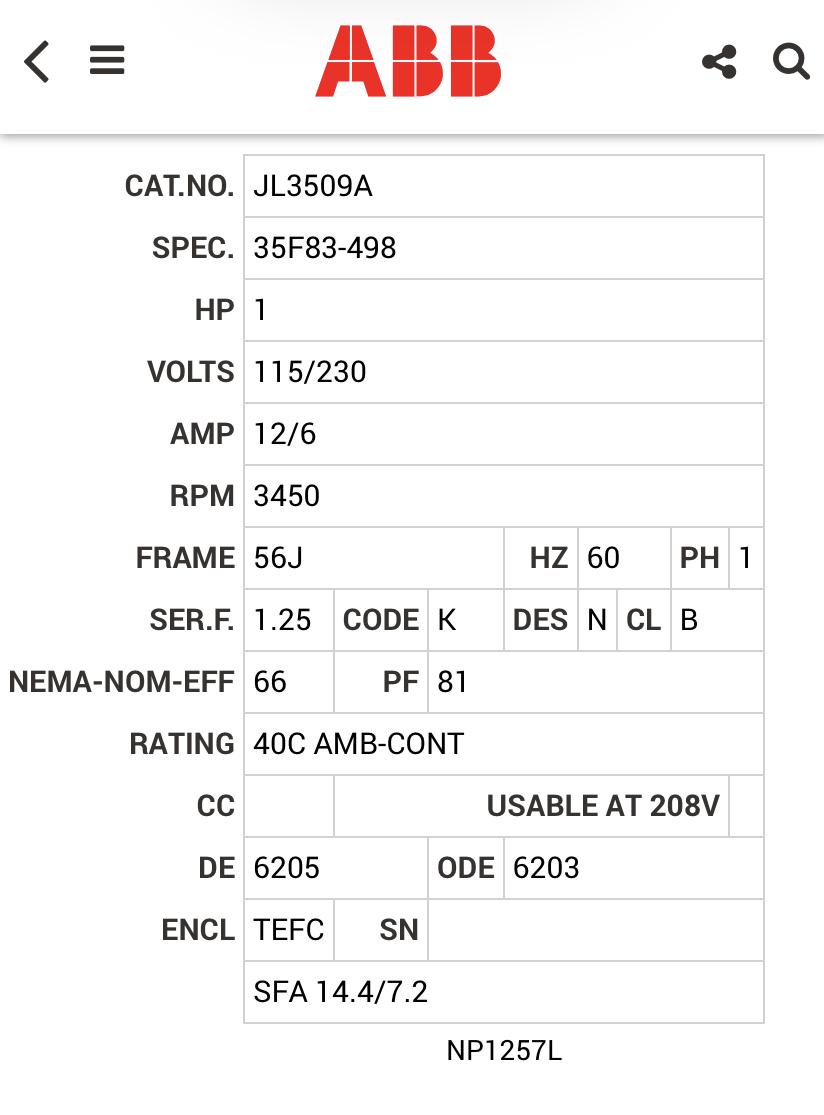

Here are some pics of the motor wiring. I didn’t realize until I had came inside that the infamous brown wire was still tucked up in the connection box. Dark outside now. So visualize a brown one on the photo. I looked up the specs which at 240 volts looks like blue and yellow are line side wires. Basically what I’m trying to do is to connect the motor to the timer. Question is how do I ground the motor, which wire would be the ground. Likewise what bonding is needed since I’m using it on an in ground swimming pool.

I see a green wire so that is your ground. Read the motor connection sticker on the pecker head and wire it for high voltage. Worse case run an external ground and just zip tie to the flex

Slow catching up. Got it all back together and up and running. I attached the ground to the motor frame and it just hummed when turned on. I turned every thing back off started studying the diagram again. After pulling the wires back out and retraining them in a little neater I pulled the isolated mystery brown out. I got my glasses on and noticed that there were two other brown wires tied together of different gauges. Sure enough they had the “J” on them. So I temped the third brown J wire with them and flipped her on. It spun up and purred like a kitten. I made a good connection on them, tucked it all back in the “Pecker head” neatly and buttoned it up. Mission accomplished. Thanks to Megawatt and other contributors for help knocking it out. Appreciate it all. 👍
