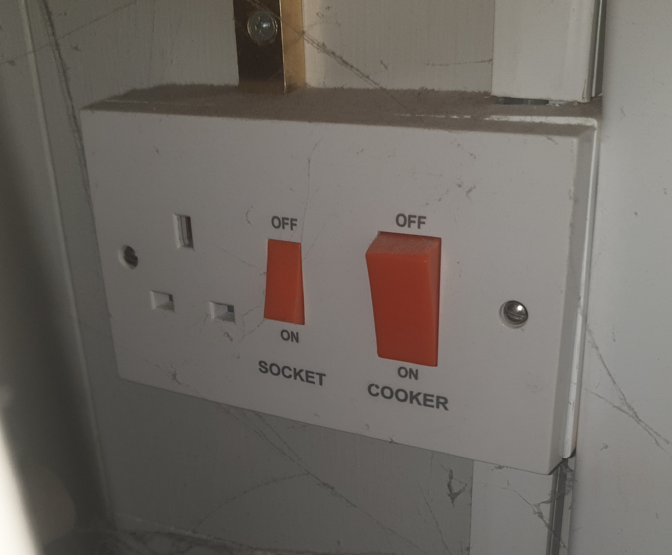

I already have a 3kw double oven hardwired with 6mm twin and earth, direct to the consumer unit. Can I also add a 2.7kw hob to the same circuit?
Alternatively, can the hob be hardwired to the kitchen circuit?
It should be fine if it's just the double oven and hob with no socket outlet on a 32amp breaker.
