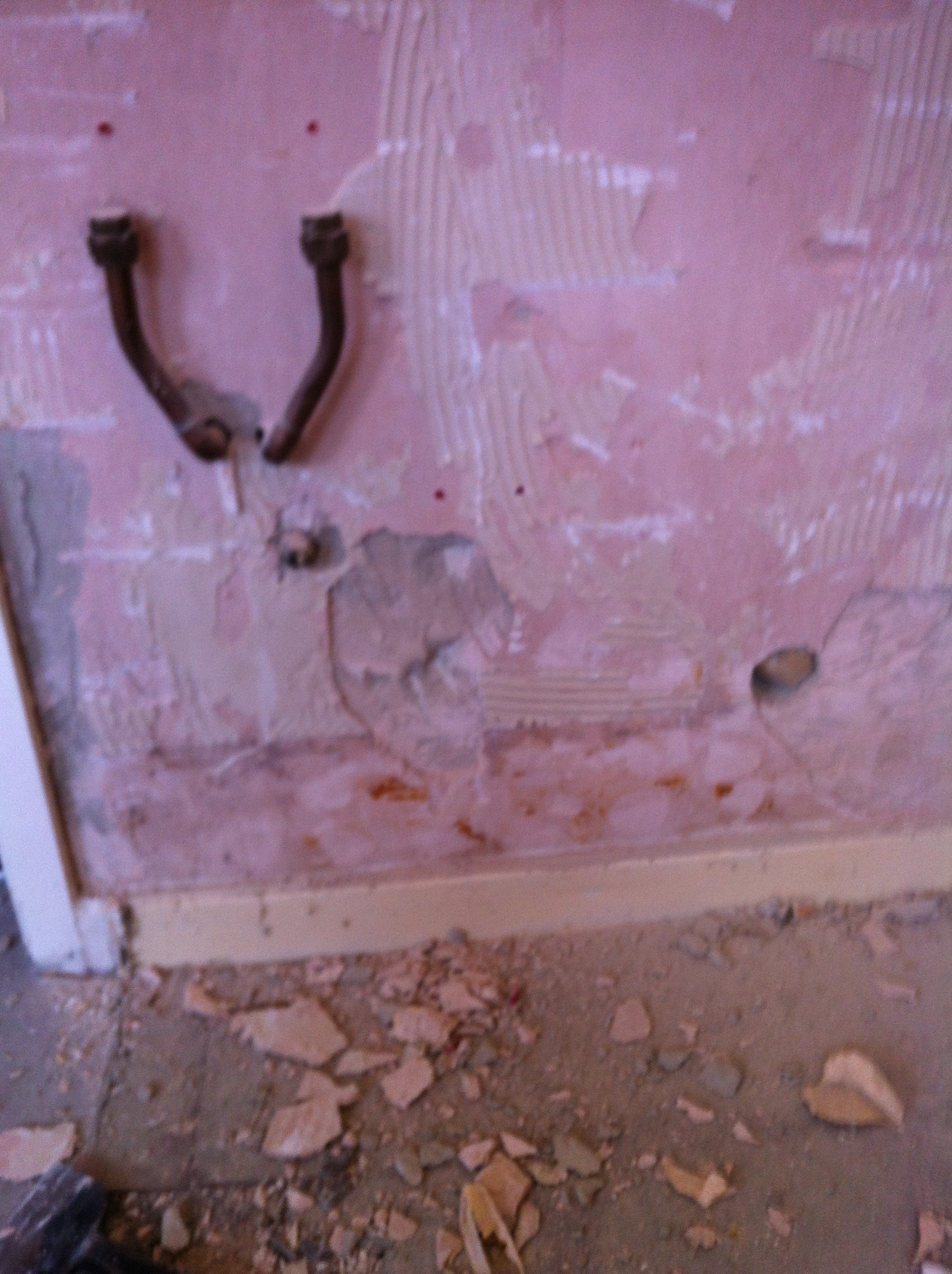

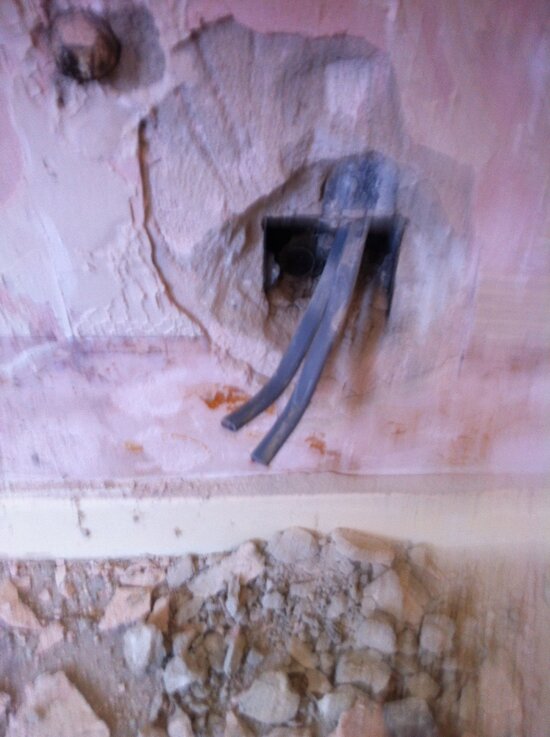

What about the plasterers that like to fold your wires (if you don't) right into the sockets and than completely skim over them leaving you to try find them or even forget one. :)
LOL. An ov
They have still been brain removed too, and are continuing the tradition.
A hammer around the sides redresses the balance a bit.;)
