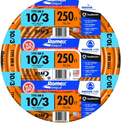

when my AC kicks on, my lights blink.
From what I know, that aint good.
I have a 200 amp service so that is not the problem
any guesses as to wth is up?
yes sir, it is a big --- orange wire. 10/3 if i remember correctly the unit is a 3 ton unit
" A big --- Orange Wire 10/3" can't seem to find that a cable of that description in the Regs Book!!! Don't think many Electricians over in the UK will be familiar with it either.
What size motor is on your AC and how is it controlled IE powered direct (DOL) to bring it on instantly or speed controlled to ramp it up?... it is not unusual for the inrush of a motor DOL to cause local flickering although we do have regulation over here about this and adding transients to the network which may effect other uses.

YES I did. I jut checked it a few minutes ago. a loose connection on the breaker screw
Thanks guys. I hate freaking wires
