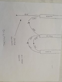

Hi
My house apparently is wired in an old fashioned way with what I believe is called a shared neutral ??? Dont really know. But my breakers are special they turn two circuits off at a time and instead of a black wire only, one breaker has a black and the other a red.
So, I need to hookup a garbage disposal unit and when I remove the cover plate to put in an outlet. However, the only wire on its own ready to tie into an outlet is a black one. There are some other wires tied together and I am sure one of those is supposed to be the neutral.
The black wire on its own does indeed get controlled by the switch on the wall. However I need help identifying which one to use as a neutral for the outlet.
Please see the attached image of my drawing so you can see what I have and maybe you can answer the question. Where you see a dot connecting the two wires indicates a wire nut.
I thank you in advance for your time looking at this.
Diagram and switch wiring attached

You should have white wires under a wire nut. The white wires I’m seeing on the devices should be taped black since they are being as live wires

Firstly I would suggest that of the three sets of cables, they are not all 'incoming'. There might be one cable (of 3 wires) bringing in permanent...

Ah yes my apologies, thank you much appreciated.
