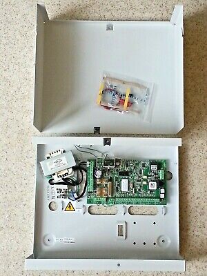

Hi all, just an update. I ordered the LM317T voltage regulator and also a replacement capacitor. I replaced the voltage regulator first. That has solved the low voltage to the Aux and Battery charging cable (both are now just above 13v DC). However, the keypad is not working, the screen is blank and every 15-20seconds it beeps, but the screen remains blank. I have charged the 7ah battery and tested it before powering up the alarm with it plugged in.
I then replaced the Capacitor on the PCB, but that doesn't make any difference. So now i'm stuck again. Not sure what else to try.
Note, before I replaced the voltage regulator I fully charged the battery and plugged it in and the alarm did work for a few hours (as it was being fully powered by the battery). So I know the battery is ok. So it's only after I replaced the voltage regulator that has led to this specific issue.
Any suggestions would be much appreciated.
Thanks
Going to be difficult diagnosing this remotely I think.
As per UNG, if you have the time, suggest checking power exists on all ic's, just to check no tracks got damaged during the replacements. Google for the pin-outs!
Have you got a circuit schematic by any chance? If not it may be time to consider a replacement ? eg:
hi all, just an update. I actually got it working. A rookie mistake i'm afraid, I mis-wired the -ve on the keypad which is what caused it to beep every 15-20seconds. So it's all working now.
The main fix was the voltage regulator that I replaced on the PCB.
Thank you all for your input/advice, it's really appreciated.
