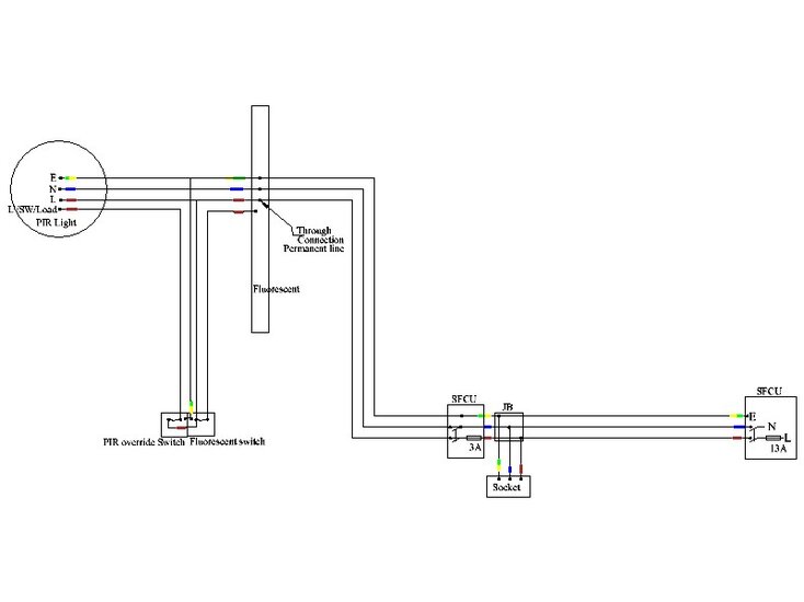

Done a quick possibility diagram of wiring for you.
If your PIR does not have the fourth contact (L', or the like, usually for connecting another light) then you will not be able to switch it on permenantly
I would tend to put an isolator switch in for the PIR so you can switch it off easily for maintenance, but this is the basics.
You could change the R7 lamp in the PIR for a low energy one at about 24W to save power.
You may also find that the terminals of the lights are a bit tight for 2.5mm but so long as you do not need to double up you should be OK, you may need to change the terminal block in the flourescent for a 30A one to get the size.
Again if you can get any one in to do this would be a good idea.
Can't really fault the practical advice above, just make sure you have some 13A fuses available! But really you should find you are OK.
On the wiring arrangement you could replace the garage socket with a small CU and have the SWA only fused by the ring OPD, but as stated above may have overload on the ring problems.
wow , thankyou for taking the time to draw a circuit. should help no end :). As you suspected, from memory when i wired the PIR the other day, it had four terminals but the fourth terminal had a black cable in it at both sides already. I dont know if it had L' on it though, i will check. But i got the 2.5mm in it without much hassle.
