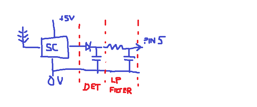

I think we should add a peak detector and low pass filter between the sensing circuit and pin 5 of the LM3914. Something like the circuit I have sketched in the attachment. Most of the 'reliable' pick up by the antenna of of signals from the hand will be due to the mains wiring since it is energised all the time, so a low pass filter which reduces other signals which are picked up beyond 50/60Hz (what is Romanian mains frequency?) will make a difference. No sums done yet by me on component values. You could make a start if you wish. Assume the frequencies beyond 1/2piCR.....
https://www.electronics-tutorials.ws/filter/filter_2.html
We will reverse the order of the two circuits I mentioned ie low pass filter and then peak detector.....so that we only find the peak of the 50/60Hz signal. You understand why I have reversed the two circuits?
Not very well... because I didnt work before with such things. But I can imagine what you are referring to. You want to filter the 50Hz , instead of shielding it. That is a briliant idea and I hope it will work, I really do.
