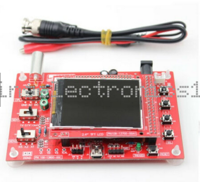

A very parallel update: Today I am happy I received my first performant oscilloscope. I am waiting for it from my past life. A lot of problems with the mail. But it finally come.
DSO138 is a digital osciloscope
I am mentioning here, because mister @marconi asked me what measurement tools I have. So this fall in that category. I have a very old and shitty osciloscope (transistorized) - it is written on it, with the most basic functions imaginable. A friend from another forum encouraged me to take this little thing as a very good upgrade for what I have, and I believe him.
Now that I have it, maybe is a game changer. But the problem is that is a tool I literally dont know how to use it yet. I understand I am not allowed to measure more than 30V with it, if im not mistaken, I have to read more specs about it. So no 220 measuring with it unfortunatly. But for the 5V on my board, it should be very good.
So from now on, consider this tool that I can use.

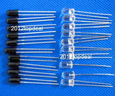

I also received my IR leds + black photo diodes in 1 package. 50 pairs total = a life time use.
I would love and oscilloscope but in reality I cannot justify the expenditure on one. That oscilloscope looks very interesting though- could you send me some details of it please? I think it will be helpful to you in your current and also future projects.

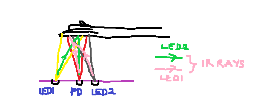

I will keep it brief now and will say more tomorrow morning. My prototype switch will reliably detect flat white sheets of paper presented to the two IR diodes. What I am having problems with is the presentation of the hand to operate the switch reliably. It often does work but the orientation of the hand and which part of my palm‘s skin is illuminated matters greatly. This is is not surprising really because the type of reflection from the smooth white appear is specular and generally consistent whereas when it is off a rough bumpy surface like skin it is diffuse. There is also more absorption of infra red light by skin than by white paper. All quite interesting as a further problem to overcome. My first thought is to use more than one photodiode to look at the illuminated patch of skin from other directions and then combine their signals to determine the presence and closeness of the skin on the palm of the hand. In other words an array of sensors.

...That oscilloscope looks very interesting though- could you send me some details of it please? ...
Yes, no problem. I actually did my homework before buying it, looking on mister YouTube for a lot of these litle osciloscopes and then comparing prices on ebay. I spent like several months doing this thing. Ofcourse, not all the time , but sporadically. Then when my friend insisted on it, I already new a lot of them so it was a smooth push for me to give in. I suggest to you to do the same. FOr sure there are many more optiones there that will satisfy your needs. My prerogatives was cheapness. Im not sure if is the same for everybody else. With these in mind, here is my cheap'o osciloscope link:

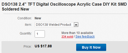

I keep a separate list on my PC for ebay purchase because they are changing with the weather. For example right now their prices changed for the same exact product:
Now is 17.88 but my deal was at 16.21. Excelent deal for me.
Without plastic case, but im building one from cardboard right now.
If you look lower in the page(scroll down) you will find Product Description, with a lot of information.
You can find at similar price if you search properly. Usually they do that, they change their name both user and product. But if you keep your eyes on the money, you will find it cheap as mine. Be careful not to buy "unsoldered ones". I emailed the guy and I was specifically tell him to send me the soldered one. Because a lot of youtubers were complaining about it, and i learn to avoid it. Youtube is your friend. Use it.
Again, I looked for the cheapest, not the quality. Just enough to do its job.
...My first thought is to use more than one photodiode to look at the illuminated patch of skin from other directions and then combine their signals to determine the presence and closeness of the skin on the palm of the hand. In other words an array of sensors....
Yes, I also suggest a RING of both, sensors and IR leds. I also recomand a high power IR led, like 1W, 3W,5W,10W. If they exist and at what price. I didnt search myself, but I will soon and update you from my side. You should give it a search as well. The ring I have in mind will have around 10x 3mm or 5mm usual leds/sensors. For the power ones, 1 will be enough.

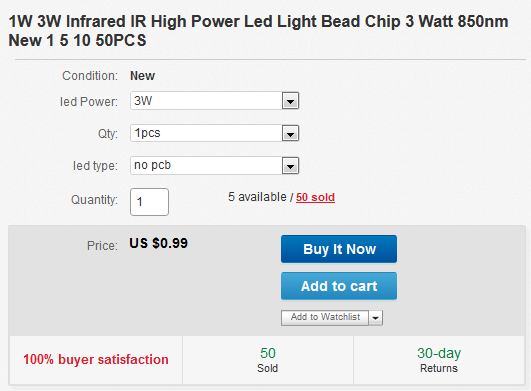

Check this out ! I was right without even searching for it, but now I searched and I find it:
LED-IR-850nm-940nm-3W-5W-10W-20W-30W-50W-100W-High-Power-Infrared
100W dude! That's what you have to buy ! Hahahaha.
Another link with the cheapest: 1W-3W-Infrared-IR-High-Power-Led
Here, 1W or 3W is the same price, so I will choose the 3W if I were you.
1$ for a 3W IR led... it's very good price. It's the cheapest I find.

Good morning. The electronic components I ordered to copy the sensor you have used did not arrive yesterday - maybe today. Today I will play with the make up of my second IR sensor which had the wider field of view photodiode. I mentioned making an array of photodiodes. The thought occurred to me yesterday afternoon while litter-picking ( don't laugh - it is good for the mind and soul!) that I could try one centre IR photodiode and two IR LEDs above and below or left and right or all four in a quad around the photodiode.

One would have to be careful upping the power of the IR radiation because I it will increase not only the desired reflections from the hand but also everything else in the field of view of the sensor which would create a background clutter signal. The most noticeable effect of this would be to illuminate the first or first few LEDs of the the ADVM. This is not something you want to occur in your (or my) final design.

The idea of using a black photodiode is very clever. I wish I had thought of that but I was not aware of them. Thank you for teaching me something.

This is what I bought and the package arrived already yesterday. The black ones are the sensors and the transparent ones are the leds.

Good morning. I have reached a point where the IR hand proximity sensor works smoothly, reliably and without any false switch ons or switch offs. I constructed an IR sensor as in the diagram in my #96; a centre photodiode with an IR LED torch to the left and to the right of it; this arrangement increases the illumination of a small patch of skin on the plam of the hand which the photodiode looks at and increases the intensity of IR light entering the photodiode from diffuse reflection off the skin. The LEDs are angled in slightly towards the photodiode. I will post a picture of it later today. It was not very bright yesterday so the ambient light level in my shed was low; with the shed lights on the first LED of the column of eight sometimes illuminated but this is far too low a Vs signal to turn the lamp on or off.
