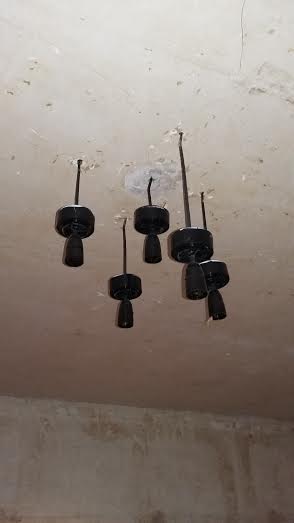

Found this on a recent eicr, it was feeding a couple of outside lights, there was a lid on it so I presumed it was being used in the usual way, the training centres must be so proud.

Didn't look Simon I just disconnected it from the switch below which was tapped off a spurred socket, there's quite a list mate.
I hope at least that is an inside wall it is fixed to.
Kind of, it was on an external wall, but covered from the weather in a makeshift lean too, with windows and a door kind of thingy mee bob
