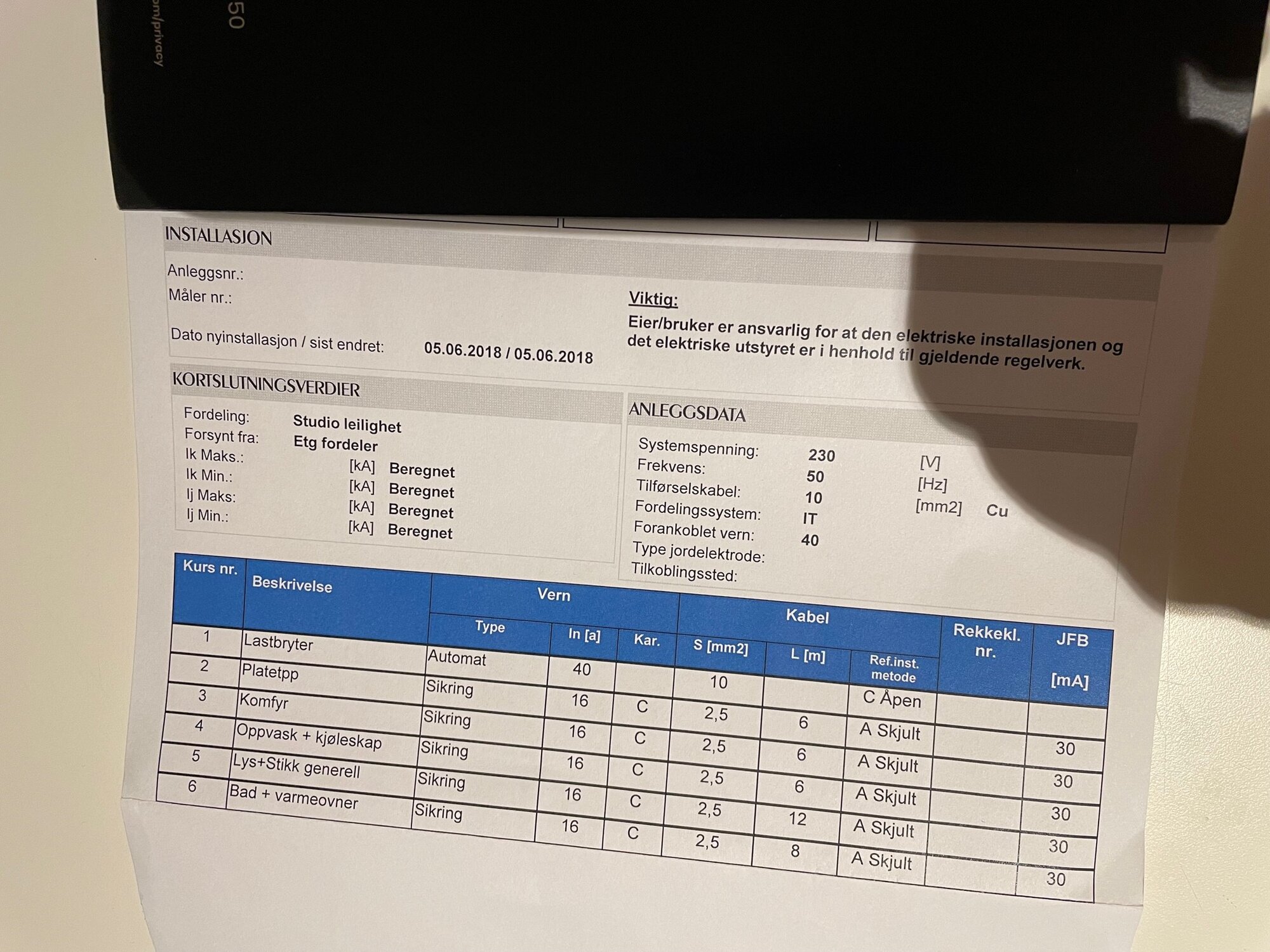

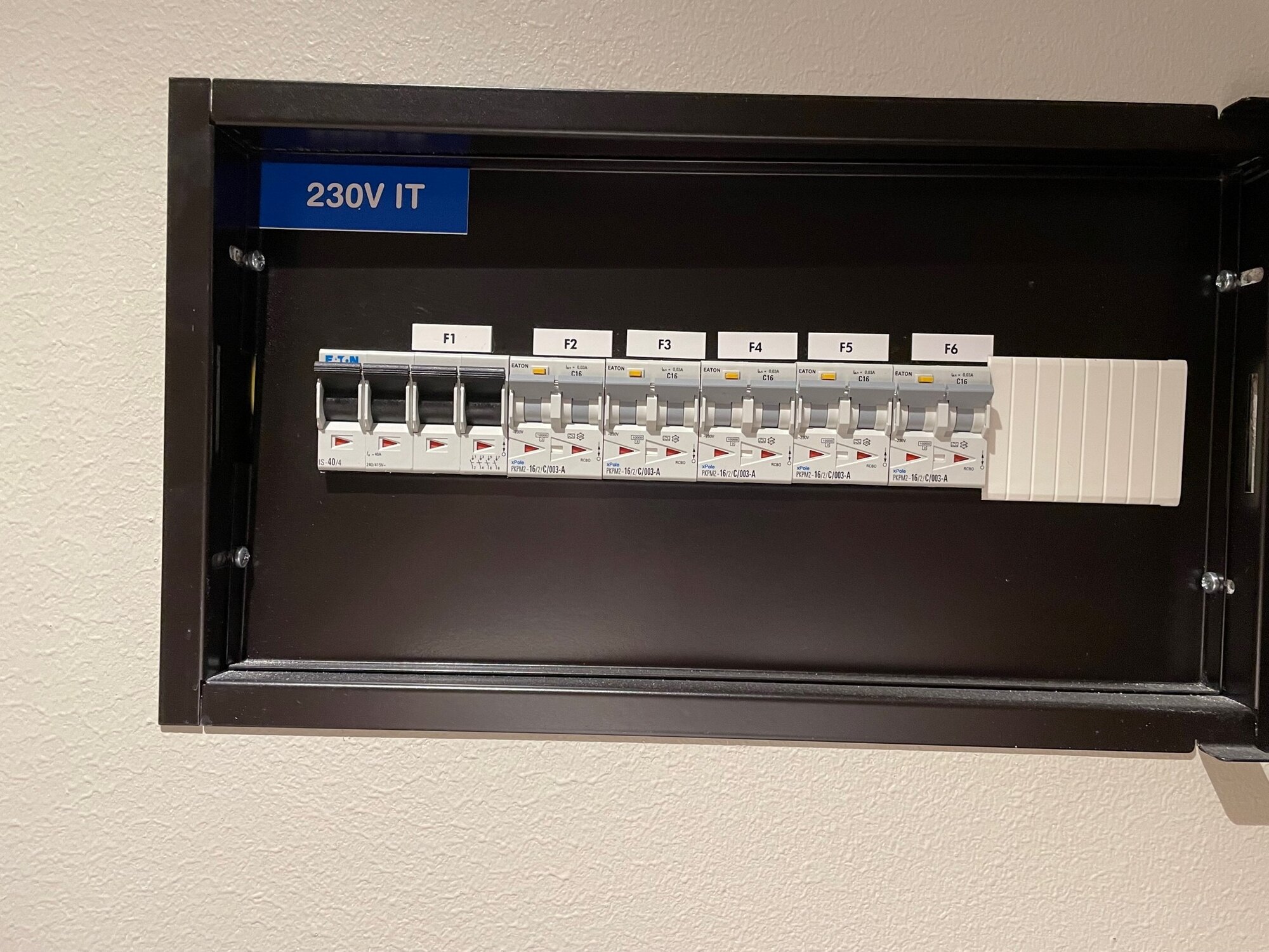

See below pictures of the DB in the flat I stayed in (yes I know, sad old git)
The RCBOs are a type that is unusual to me, perhaps someone else can explain how they work.
The IT earthing is widespread it is common for an earth fault in one house to cause a rise in potential of the neutral in adjacent houses. They have a system which predates RCDs where a fuse was inserted between neutral and earth, if the fuse blew a flag would drop to alert the customer who would then call in an electrician ( in theory). I was told the name of this system but cant pronounce it never mind spell it, Again perhaps someone on here could explain a bit more.
Jordfeilvarsler? (=earth fault warning device)
I don't know how they were configured other than that they tended to trip even if the fault was outside of your own property, which is one of the snags of IT supplies - an insulation fault in one causes abnormal conditions in all, as you noted. Will investigate.
