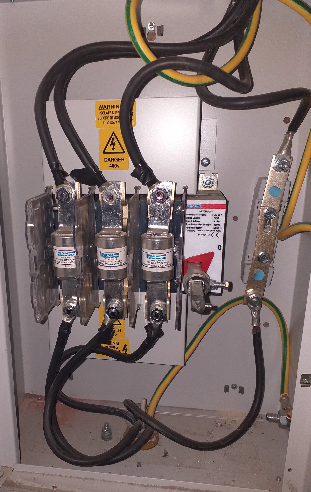

Awful time of a new installation by an idiot! He spent most of his time with his phone attached to his ear held between his shoulder and face!
The "dead man's switch" was put on back to front, so when the door was opened NOTHING got turned off!
He cut off all the earth wires to 240V metal lights at floor level and in window boards (uplights)
No Grommets in Main fuse box, cut out the top of the box in a really jagged way and then attached a bit of tape around the cutout.
Armoured cable left exposed at the ends.
Earth wires twisted together with no sheathing.
Switches with wires going nowhere!
Cables inserted into fuses but not tightened in with the end of the cable running outside and also in one of the cupboards.

It is certainly a good distance away from what i would consider a professional job.
however from what you have shown so far, it is possibly not a big job to put right.
glanding off armoured cables is probabley required but might not be, if the armour is earthed at the other end (i doubt it but it might be)
taped connector blocks just shout "WRONG" at me, BUT it may just be an unused cable being stowed away for later use?
the 3rd photo with the fused isolator, not sure what is wrong with it, maybe i am missing something?
It's back to front....he's wired it in around the wrong way. When the handle is used and the door opened it doesn't cut the current!
He got another fella to sign it off....he's been back and took the board to bits and put it all back again....HAD to didn't he!

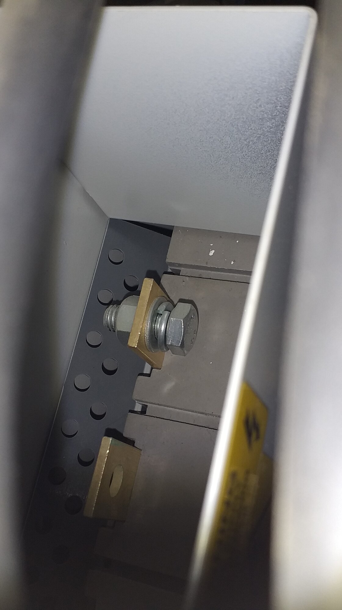

p.s. I still can't see what is wrong with the picture of the isolator unless it is not a fused isolator and the fused have been added to bridge the isolator.
The neutral conductors are connected across the wrong bolts for starters they have connected across the removable link bolts.
Agreed, however can you see why it is not isolating?
I am presuming that it is a fused isolator and, F me just realised!
it is either not a fused isolator or the feed in cables are in the wrong place.
dumb moment on my part!!!
