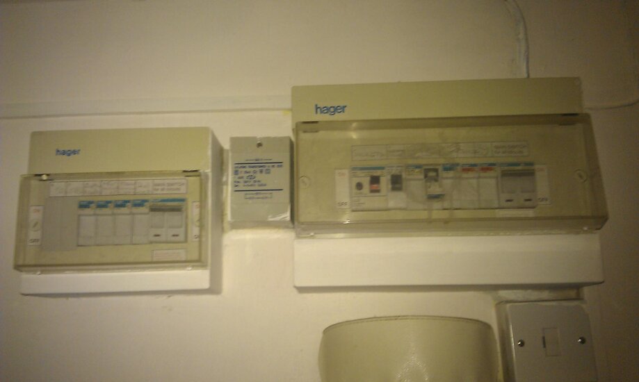

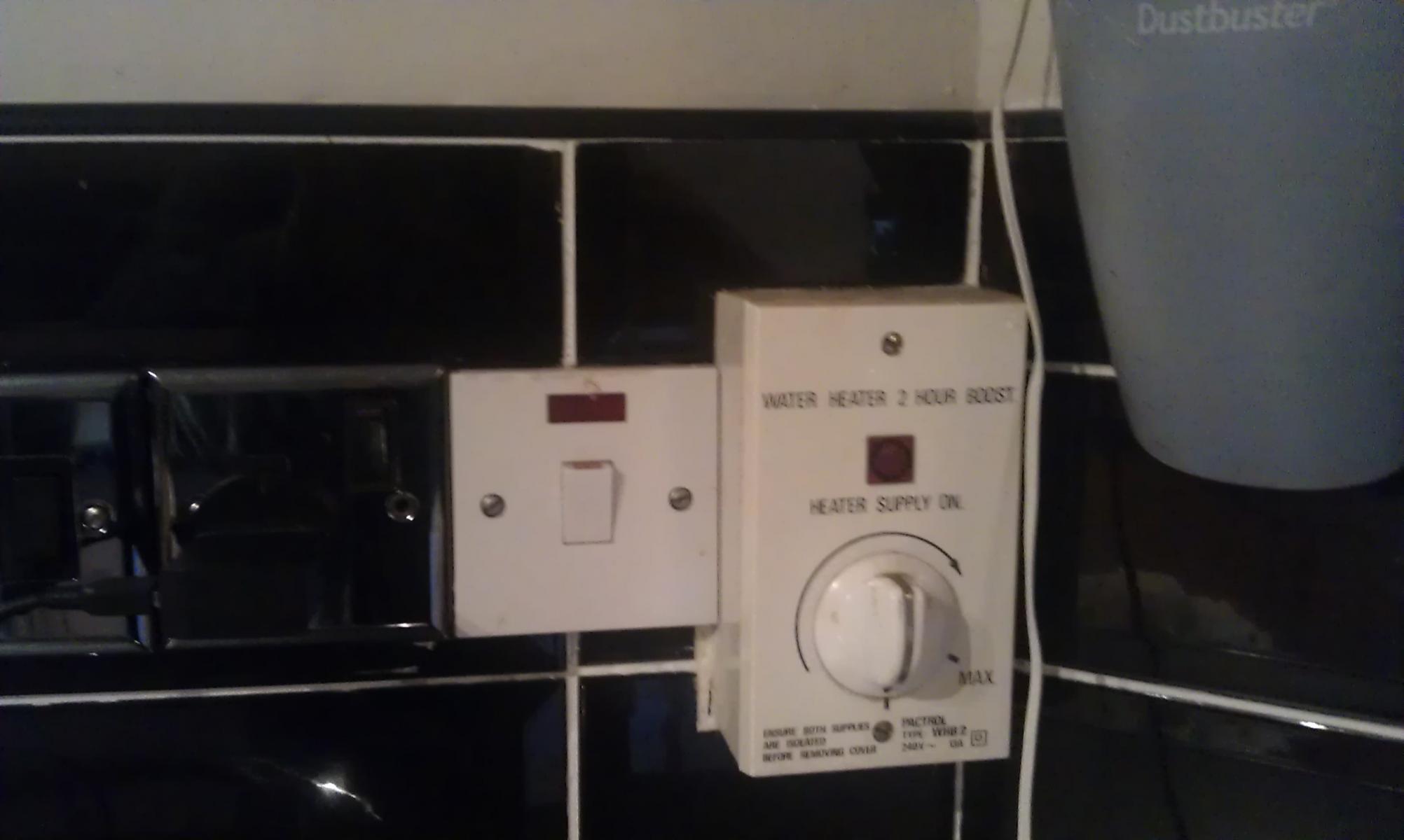

if it was a proper eco 7 you would have this or maybe you do as this is a timer and boost or do you just have aboost plus send in pictures of the fuseboard area and boost unit for a definitive answer
Forgot to add that you may have a common timer at the consumer unit anyhow pictures please

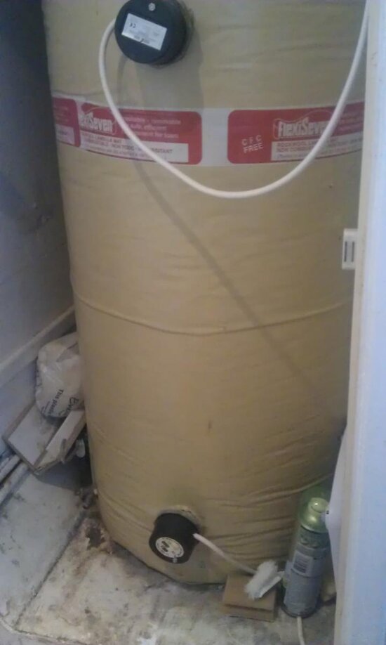

my money is on the stat to the bottom heater or the fuse to off peak/or s/spur is off/blown. Its the first two things i always check on a call like this. The OP says the elements were checked and mentioned boost so must be an eco clock as oldtimer has posted so not much left to look at. Still all this makes the last sparks look a bit silly, I would get him back for free but easy for me to say when your in the game.
Needaspark me thinks you are spot on yes the off peak side may not be working but a spark worth his salt with a trusty multimeter could measure the resistance of the circuit back at the off peak board if they get 18-19 ohms then yep it ok if not then they move on to the element and measure across the nuetral and pre then after the thermostat if after (the leg going on to the element) gives you 18 ohms then replace the stat I must say though 90% of faults I look at like this is the thermostat the other 10% is a burnt out connection on the element or indeed a duff element.

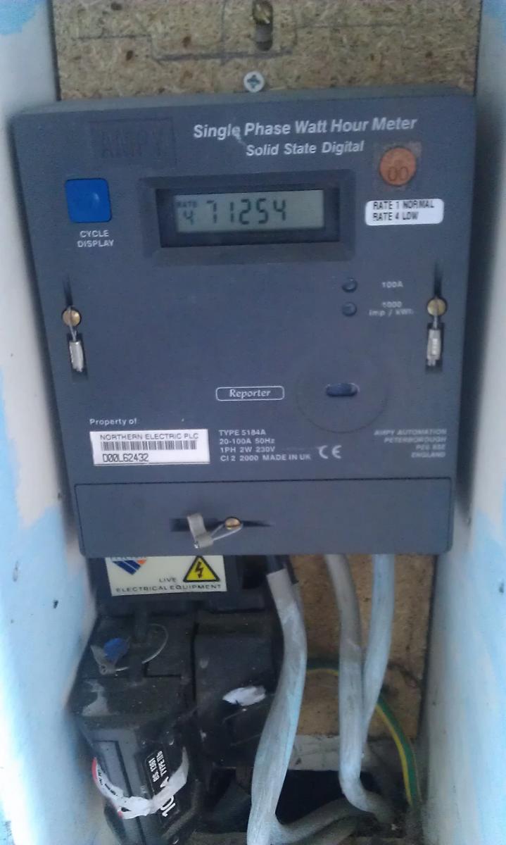

There are some meters that changeover using radio teleswitching (BBC Radio 4 Long wave carries the superimposed switching data) which allows the electric companies to vary the off peak periods so there is not a timeswitch to control the economy 7. From the original post it sounds like there is a wiring issue or possibly a failed contactor or relay

fuses. There are two on the box when i've looked. 15amp chunky blue ones. IMAG0072.jpgIMAG0070.jpgIMAG0071.jpgIMAG0073.jpgIMAG0074.jpg

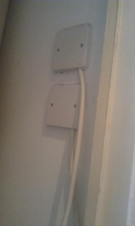

Here is my set up, pic 1 is the fuse box, two fuses that say 'water heater', pic 2 tank with two immersions, pic 3 is the electic points for the tank, pic 4 is the boost switch and spur that comes on 1am to 8am, pic 5 is the meter. This is all that I know i've got as a set up.

If you want to know if the supply exists at the spur,change it to a socket.plug a radio in with the volume full blast,then go to bed,if you sleep well you aint got no supply
