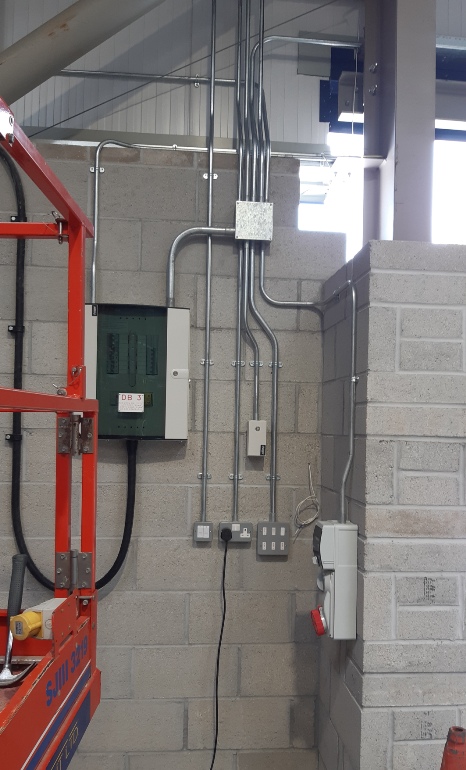

@norcal I’m not impressed when I run conduit there is no discrepancies in the gaps between my conduit and I measure center to center. Some of it looked good but the conduit on the right coming out of the top of that one Panel personally I would have made them tear it out and start over.
Would it not be better to run fewer but bigger conduits...?
I have seen videos of these type of conduit installations in America with dozens of small gauge conduits running from box to box with one cable per conduit.
seems such a waste of raw materials (not to mention labour) when you could run 4 or 5 circuits in one slightly bigger conduit....
there is that , also drawing multiple cables together runs the risk of burning / chaffing the basic insulation.
i still can’t help thinking if I have to get 5 cables (circuits) from A to B there must be a better solution than 5 completely separate conduit pipes...
It was in the USA so no T&E, five circuits = fifteen cables?
potentially , unless they could share one oversized cpc ... or use the conduit as a cpc but I’m not sure if that is allowed over there ...

I’ll have to say guys and girls that their is no cables in them conduits. We pull all single stranded wire. The big pipes probably have bigger wire in them for feeders. I’ve seen 100 # 14 control wires in some of the bigger conduits. I’ve wired a lot of European equipment and a lot of times they will bring there own cables with them from across the pond and if that’s the case we use tray cable. We can’t mix analog with digital inputs and outputs in the same conduit and power feeders in there own conduit and communication cat-5 cables in there own conduit. We do not like pulling European cables in conduit because the outside diameter of the cable makes us have to run at least 3 inch conduit. Yes most of that conduit looks awesome but I’m a perfectionist on conduit and I seen some conduits that the gap between Some of them is not consistent. I’ve worked for Germans, Italy, Finland engineers, etc who all use cables. In the US on a job that big mostly we have to go by the prints who dictates what we do. On big jobs we have people that just run conduit and nothing else, people who mount all the pull cans and panels. It’s so much different over here.

in the u.k we generally pull single cables (wires) in conduit pipes , you do get some people pull in Romex style cable in conduit but that generally more in houses.
europans do pull in round cable in their conduit but that’s more flexi plastic type conduit tubing I think...I have seen Europea conduit that doesn’t even have bends / elbows
