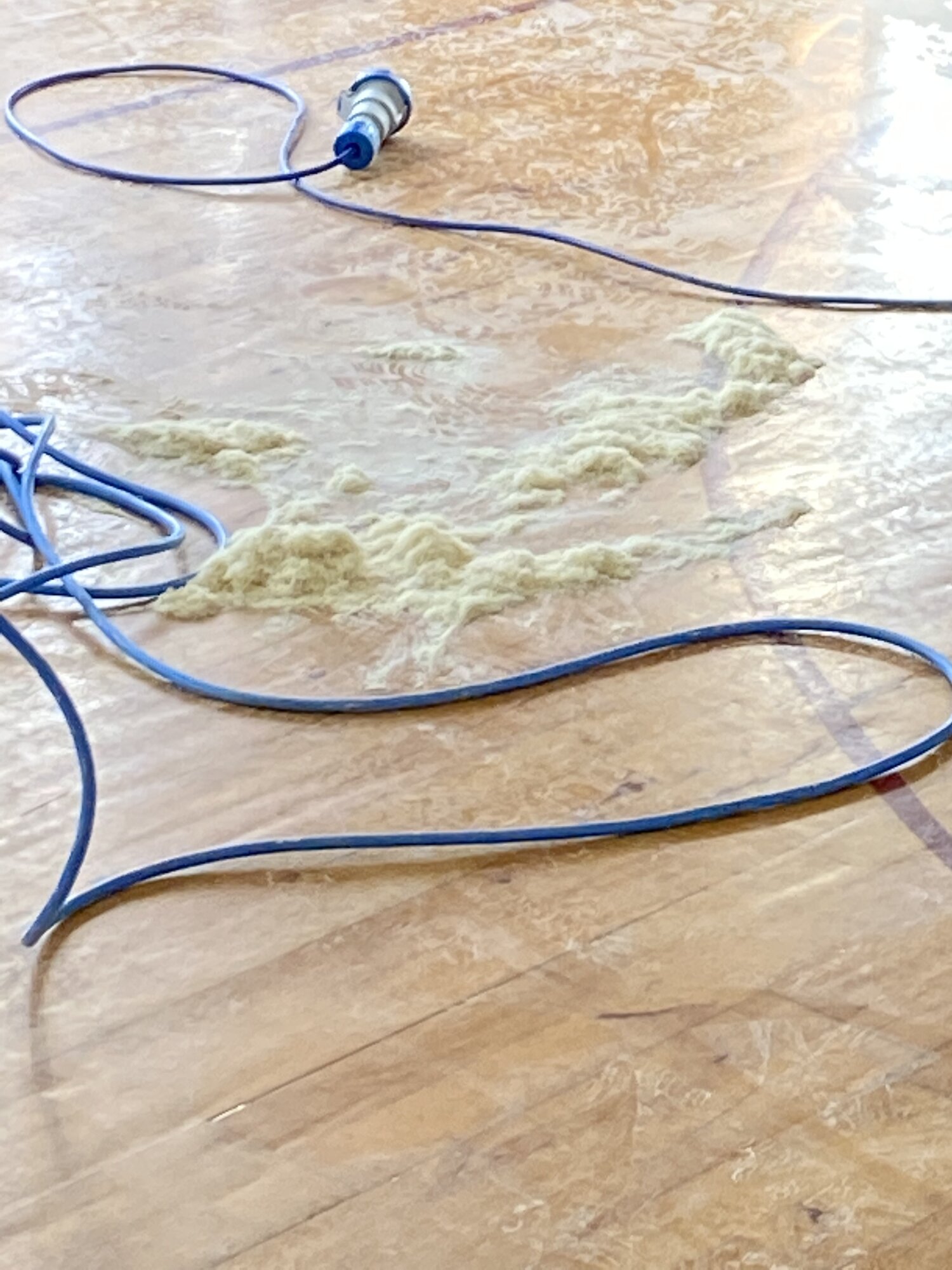

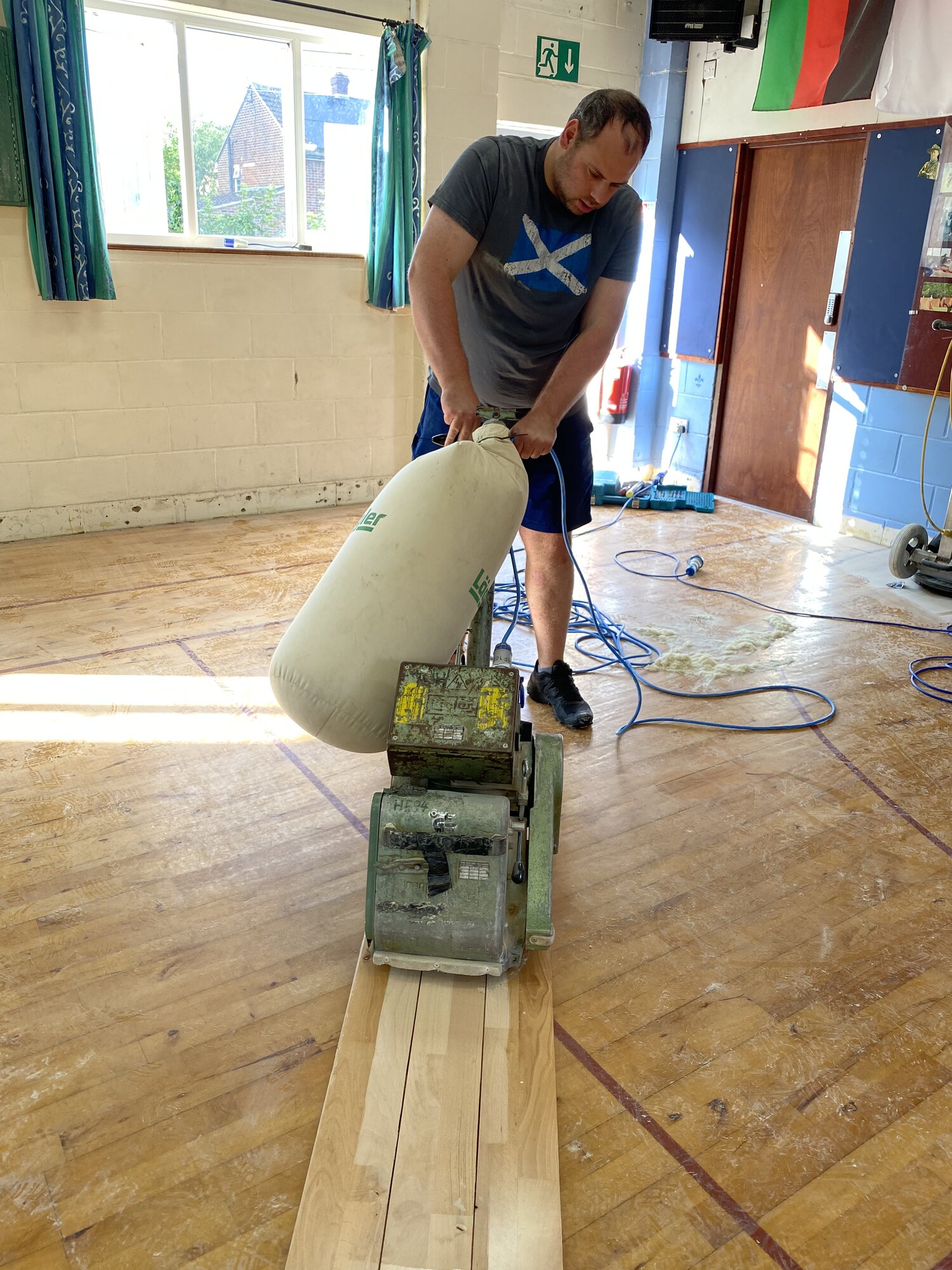

The moral of the story - trust your first instincts and ensure the contractor has checked and unblocked his machine!
Thanks for all who replied to my original post.

We had similar problems at work with scarifier.
The OPs were starting it engaging with the floor.
Turns out it needed to be tiped back and upto speed before it was engaged with the floor.
If engeged straight off it would overload and trip breaker it thr DB or tripped the trany
I did wonder if that was the issue here, these appliances are quite aggressive.
