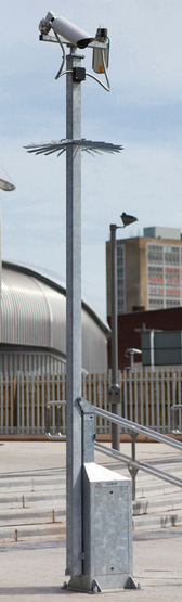

Grateful for a kick in the right direction on the following: a telecomms engineer stated out that an outdoor metal cabinet (earthed & bonded) was an unsuitable enclosure for a network switch and patch panel to be installed into, as it was not IP rated.
As it happened, the size of the cabinet was too shallow for the kit anyway and the install could not go ahead. The client laid out quite a few grand to get some alterative cabinets procured and installed that were IP rated (and big enough) in order to meet an important deadline.
Basically an arguement is now kicking off about whether a larger version of the original intended cabinet is suitable or not. The reason the cabinet fails IP rating is because the base is open and sits on a concrete platform, with a core hole through the base of that to fresh air.
I don't think rain ingress is likely looking at the cabinet (although theoretically possible). Much more likely is condensation inside when the weather turns as the LV network switch will genarate warmth/heat.
Anyway with the background of out the way i would like to ask if the telecomms engineer is correct? I get that it is best practise etc to install into an IP rated enclosure, but is this an actual black and white regulation? and if so does anyone know what that reg. is? The client has been installing to similar non IP rated enclosures on other jobs so this is now turning into a p!ssing contest on Site and i would be very grateful if one of you learned sparks could settle the dispute.
Thanks in advance

Why core holes open to fresh air?
Does this concrete base stand up off the ground?
Do cables enter through the hole?
Is the hole for ventillation?
Does the cabinet have vents on the sides?
There are millions of ground mounted cabinets with no base, mounted on concrete plinths with ducting or chambers below for Telecoms / CATV / Street lighting / Pumps etc

core hole to fresh air as in train station platform with inaccessible (to the public) void underneath. dust, dirt, insect, cold air ingress inevitable.
The cabinet touches down to the platform, does not stand above it.
The cabinet/platform base core hole is not for anything other than cable entry. The hole is about six inches diameter, 5% of available space used, maximum, for cables.
Yes cables enter through that hole. with large spare capacity. too much really.
The cab has no holes in the sides.

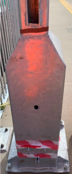

Does this cabinet not have a plinth to raise it off the ground

There is a hole in the side towards the top, that a bolt enters through. Water ingress unlikely, but theoretically possible.
There are plenty of sealants available that would seal a bolt in situ even some rubber washers would do

I was advised today that they are going to seal the core hole, which will help a lot and give it some kind of functional equivalent of an IP rating, but it will still not be an officially IP rated enclosure.
So how are they intending to seal the hole

Pic on the left is the cabinet in question, with tilt down post fitted. Pic on the right is cabinet before tilt down post is fitted. circular hole is where a bolt enters and exits which can be locked inside the cabinet to stop unauthorised tilting of the pole.
The engineer expected to see an IP rated cabinet inside this to fit an internal use type non-ruggedised network switch and patch panel into.
In other words, regardless of what the design specified, is there a regulation that governs what is a suitable enclosure for fitting sensitive electrical equipment into, or does an engineer follow a design unquestioningly. Designs aren't always correct.
