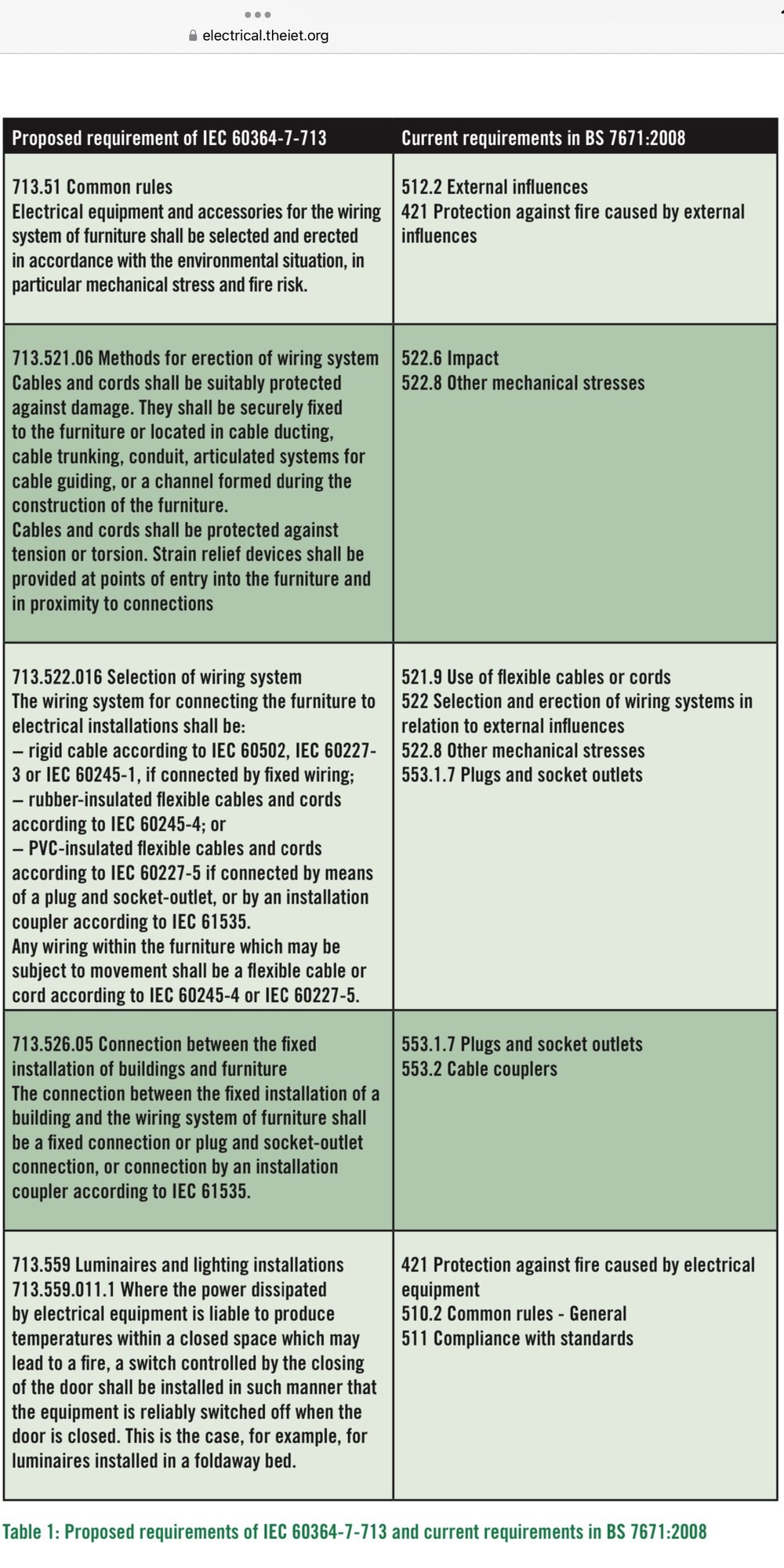

That's probably true if your furniture product comes within the scope of IEC60364-7-713!
The iet seem to think furniture wired into a fixed installation would come under BS7671
This from an iet leaflet a long time ago!
