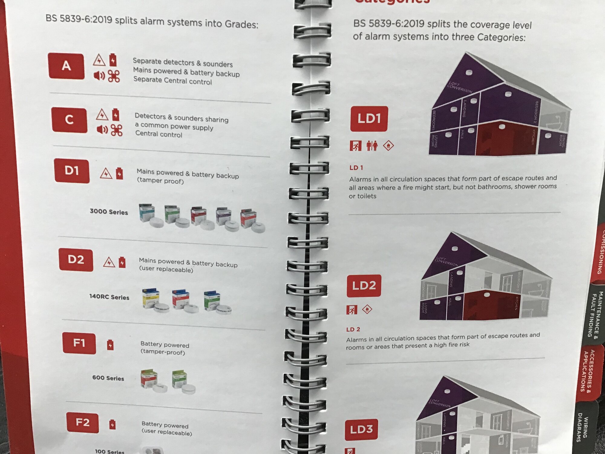

As an observation rental properties should not have battery backed ionisation alarms fitted , should be optical with built in rechargable battery ie:3016 from AICO , this applies in hallways and general living spaces , heat alarm in the kitchen , ionisation are acceptable in bedrooms.
Where does it state this? I was advised by the local authority to fit a mains powered interconnected system. There was no additional stipulation.
Can you clarify please.
Wouldn't surprise me if he's also right on the requirement for mains +rechargeable
That's the way it should be for rented accommodation, as near as possible to a maintenance free system
So what the council are now requiring here(Eire) when leasing property for rental is a fire panel fitted , seems like overkill but...
This is from the Aico electrical contractors handbook
So "recommended", not "mandatory". But I'd not user user-replacable batteries anyhow - to tenants they are either a nuisance that can be silenced by removing the battery, or a handy spare battery for something else ?
