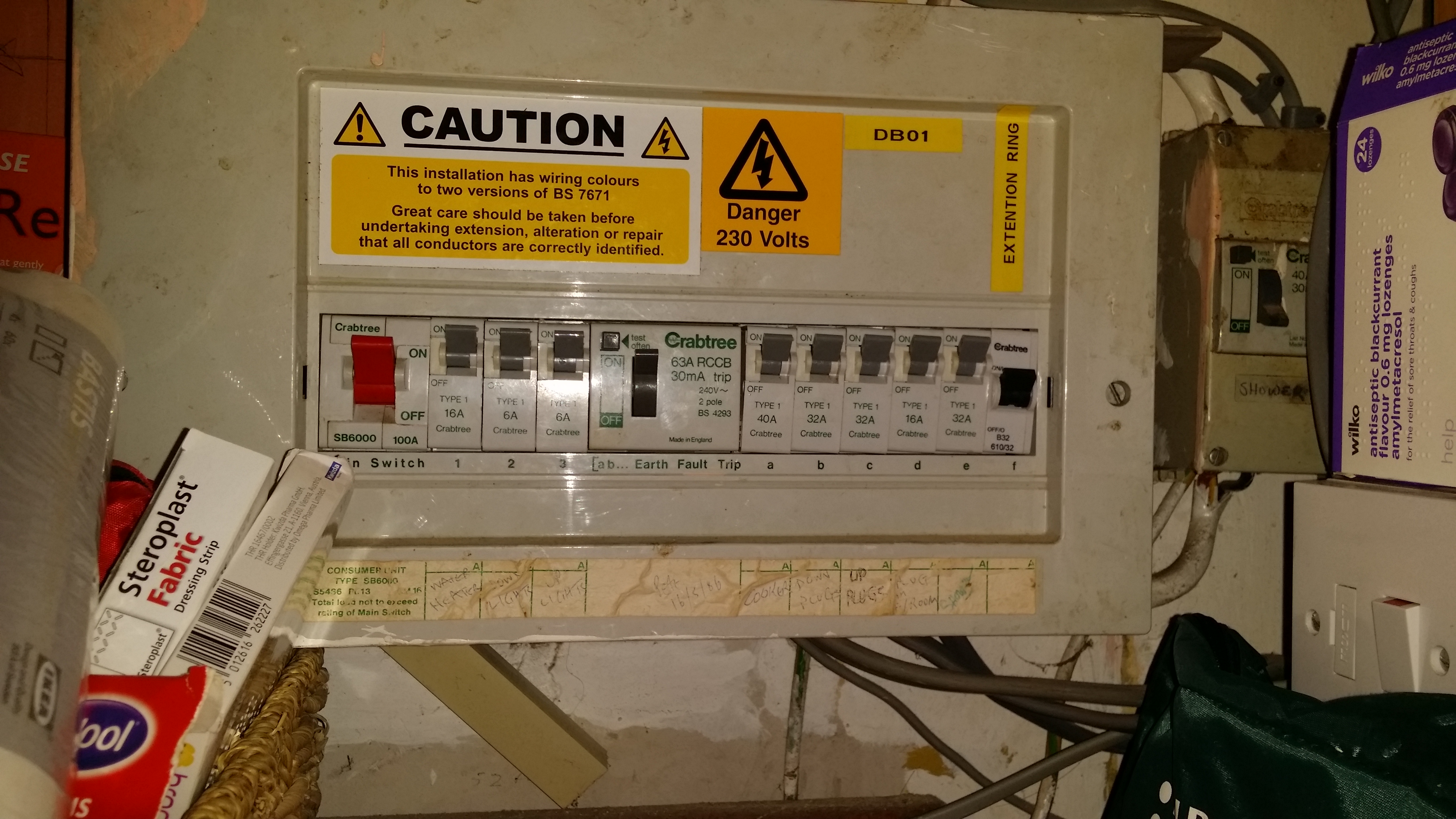

I want same electrical work done, it's not new works just replacement as in I don't want single light pendants in my hallways I want downlighters,a couple surface mounted cables buried and surface mounted sockets moved down and sunk in the wall. The fella is telling me that I need a new whole new fuse box because that's the new regs. I didn't think downlighters had to be RCD protected. This is a picture of my box and I believe that it doesn't need replacing.

The quote seems ok to me, but difficult to judge from afar. You could try the sparks that lashed in that thing to the right of your fuseboard and all those other untidy cables. :)

Part of the work is to 'Chase light switch and cables'. If you are burying cables in a wall then they have to be RCD protected. They easiest way to do this is probably to change the consumer unit. Also, I see that you are in Wandsworth. Does that mean it could take a long time to drive to your house and be a nightmare to park once there? These things have to be taken into account too.
