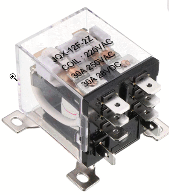

Hi
My electrical background is Auto Electrics from decades ago - 230v electiics experience is very mucch DIY.
Willis type 3kw heater. Currently switched with a DPST Manual switch.
I am hopping to add a relay in parallel with the manual switch. Relay will be switched from a SONOF / eWeLink smart switch with 230v AC output.
Just double checking if there is anything I have missed regarding the spec / suitability of this DPDT relay?
I am OK with working out what coonnections to use and not use.
If any isues with this relay please sugest an alternative.
JQX-12F-2Z AC 220V Coil 30A Relay DPDT 2NO 2NC 8 Pin General Purpose High Power Relay​

I would use a din rail dp contactor in an enclosure.

This contactor you suggested unfortunately only has two NO switches rather than 1 NC and 1 NO required for the CR3 current sensing bypass...
