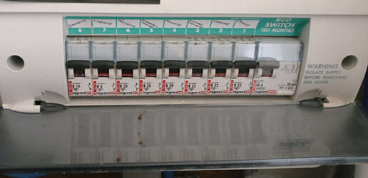

Certainly the RCD not operating is a C2. There appears to be an RCD main switch according to the schedule of test results, but the Part 9 suggests otherwise. Maybe sloppy completion of the form, but can you post a photo of the consumer unit, to confirm.

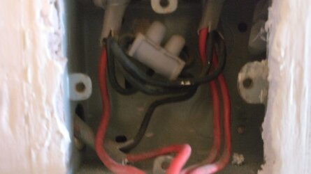

Not having earthed the switch metal back boxes, either there is a CPC but just not connected, or no CPC and can't be. Difficult to know what to believe. Just possibly there is a CPC to the lighting points but not the switch drops, I've seen that sometimes in properties of a certain age, but it is not clear.
Re the C2 for multiple cables in the MCB for circuits 4, 6 and 7 - these are radial circuits and might well have a branch at the origin. Some people may comment it is not good practice, but it is certainly not a C2.

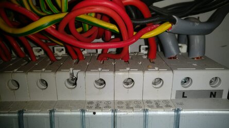

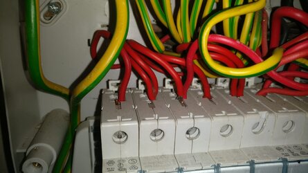

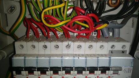

@SJD, thank you for this. I will try to get a photo of the CU (though I've agreed all access is arranged via the letting agency). There is only one light in the bathroom but defect was noted under both 8.6 and 8.7?
The light switches are metal faced (swapped a few years ago but can be reverted to plastic if need be).

I do query item 6 - multiple cables in an MCB for radial socket circuits and lighting circuits is never a C2, especially when each circuit is only covering a few sockets/lights.
Item 4 is written badly, as apparently a CPC does exist on the lighting circuit leaving the CU, though it may well not reach the switches or lighting fittings.
Might have been someone 'rewiring' the first leg and not the rest, but seems unlikely if the cable is old - (Don't think you have ever been able to get a 1mm/0.75mm twin and earth in metric sizing?)

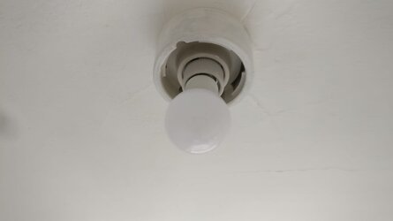

The light is listed twice presumably because it's in a zone (and not suitable) and also if the cover is missing then not considered suitable generally for its location (liable to be splashed) - so if it was outside a zone but still unsuitable it would only be listed once - fixing one of the issues would almost always fix the other anyway and a cheap surface LED fitting solves it easily.
I've noted though that some inspectors get very fussy over lights in bathrooms which are really not that big an issue - non IP rated downlights that are above 2.25m high should not be a C2 for example, and even otherwise unless directly over a shower would mostly be a C3 for me unless obvious deterioration.
Outside the zones there is nothing technically preventing a pendant fitting, other than 'good practise', which is subjective - and a huge number of houses built in the 80s-90s seem to have had a batten fitting put in the bathroom from the start...
