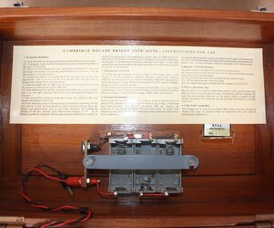

Looks like the meter has been "upgraded" on yours Tel,
V126 4.5v battery from the link below, unless your has been modded for 4 x "C" cell as pic below.

A bargain indeed if the below is anything to go by:

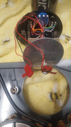

update.. opened it up and found this. galvo has deffo been updated as it has a PCB and on it there's a 8 legged microchip. there's 2 sets if leads coming off ending in 2 PP£ connectors, but no connection to the internals of the machine, and no apparent place for them to go. pointless fitting PP3/s as would just be a stand alone galvanometer . Any ideas???
  • [ElectriciansForums.net] Latest Acquisition and it's mint.
further investigation finds that the 2 securing release pillars for the galvo are actually terminals, connected to both the galvo and the internal resistor banks. tomorrow will try and see if connecting 2 PP3s will get some life into it. if i read it right, maybe someone has modded it to use PP3s instead of the original battery, necessitating the removal of the meter to replace said batteries. weird.
