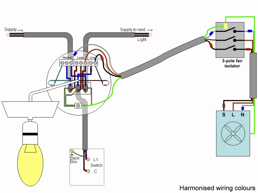

A friend of mine has just replaced some halogen GU10 lamps in his bathroom with LED lamps from Amazon.
Hes saying since swapping the lamps, the extractor fan runs continuously. (230v in-line unit in the loft with over run timer)
He tried swapping one LED lamp back to halogen and it worked as it should, timing out after 5mins or so.
Removed the halogen (with the lights switched off) and the fan fired up by itself!
Anyone come across this before? Sounds like a resistance issue to me, would a resistor sort this out?
Cheers

You're mixing inductance and capacitance up, they are two different things.
Capacitive coupling is the effect which caused CFLs to flash and LEDs to glow/flash when installed on some 2 way switched circuits.
In what way are you suggesting it has been wired incorrectly? Can you describe the wiring method you think will cause this bizarre behaviour? I am curious as I cannot think of any way of connecting this which will cause he behaviour described.
It's wired correctly as I installed it about 18 months ago.
Hager J804 in the loft, feed in, twin to pull cord, twin to spotlights and a 3c&e to TP fan isolator then onto the fan.
Fan is a Manrose MF100T, wiring hasn't been interfered with in the meantime.
Ah I see now, so the N and E are in between the two Lines of the cable.

I think in these cases, it's just a case of the circuit acting as a capacitor connected across an AC voltage source.
So it's just the 'natural' (high end terminology there!!!) current flow, in these cases in the order of micro Amps.
Which are starting to have a/or producing, odd effects on newer low power gear.
This may, or maynot be helpful but....
Today I investigated a bathroom where the lights (LED's) stayed on when the lights were off!
So I removed the cover of the ceiling mounted fan...... and narrowly avoided being "drenched" by the build up of water (condensation) that had accumulated and clearly the moisture was providing the "connection" between the SL and L.
With the fan cover off, and the fan disconnected, the lights now work perfectly.
