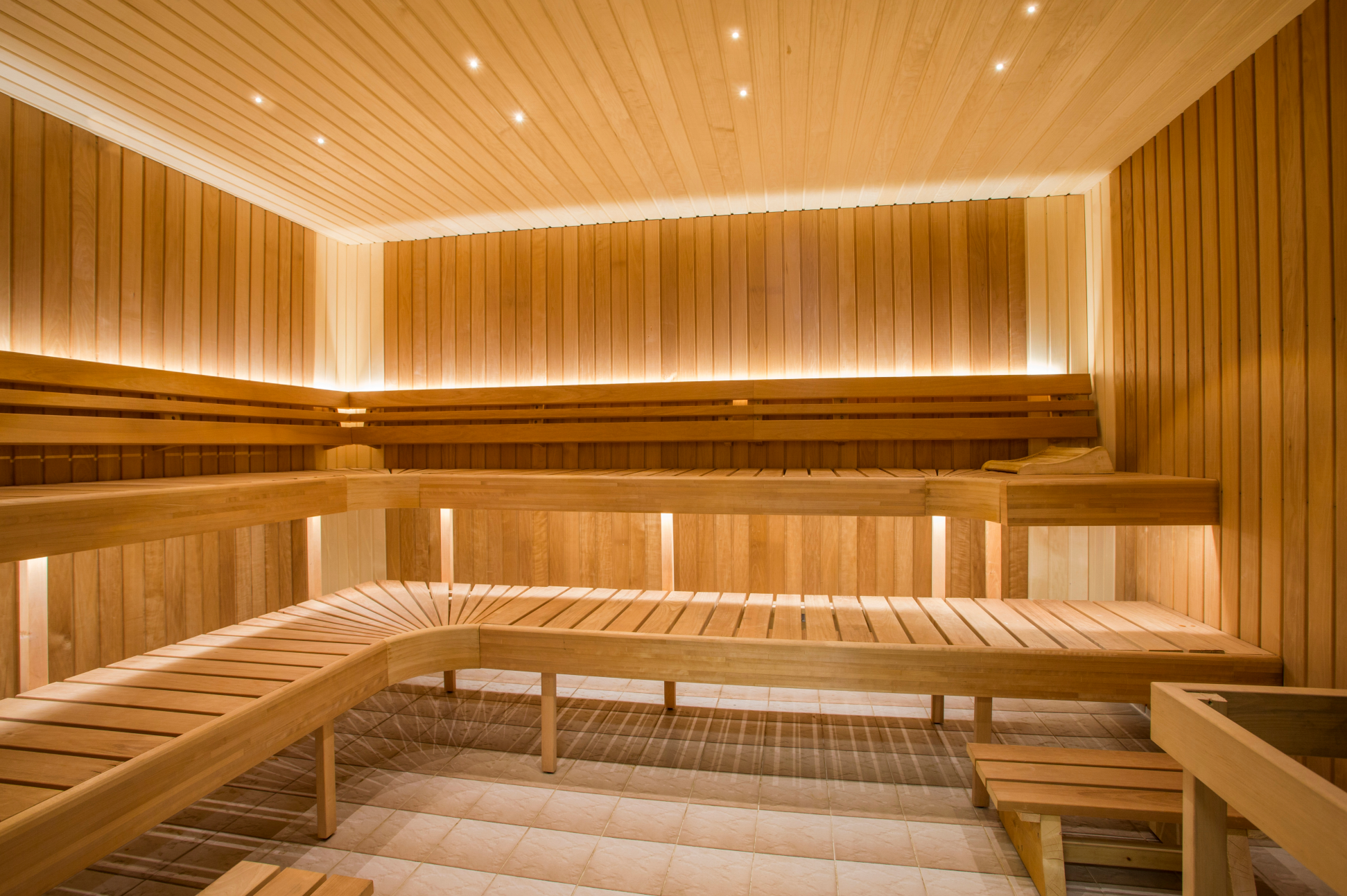

Hi all,
I’m in the process of installing an en suite with a shower enclosure. I’ve created a recess inside the shower which will be fully tiled and sealed with moisture board behind.
I’d like to put an LED strip on the rear underside of the recess. What’s the best way to make this as safe as possible? I appreciate water and electric don’t mix so want to make this as safe as possible.
My thoughts were IP65 rated LED strip encapsulated in a housing of some sort with the wires completely behind all tiling and within the void space between the walls then fed up into the loft.
I’d be grateful for your views?
Cheers
701.55 (i) says it has to be suitable for that use according to the manufacturers instructions - so buy carefully!
I've used this sort of thing before.
