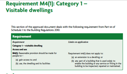

Thanks for all the comments - I phoned the local building control dept this morning and he was very clear that these heights are the new British Standard and, as such, even a re wire must conform if you want it signed off!!! Looks like We’re stuck with it - despite being on the first floor of a block without a lift (where a wheelchair user could never live!!). PC gone mad!!!
he's incorrect. it is not a new british standard. it is a building regulation for new build homes.designed for use by persons with limited reach. both your building control guy and your sparks are wrong. switches should be placed according to existing positions or lower, as long as they are no less accessible than they were before.
He is absolutely wrong. They often are. Ignore this opinion as the electrician will be "signing off" the rewire themselves. Your local building control merely get informed the work has been done and complies by the electrician's scheme.

Socket heights are a component of Building regulations Part M. They apply to new dwellings and to dwellings undergoing what is termed "material alteration".
A rewire of an existing building is neither of these. Tell him to read the building regs.
If he is to apply Part M, then there would need to be ramps, a downstairs WC with wheelchair access, all sorts of things.
