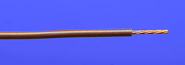

When you say singles, do you actually mean 6241Y:
[ElectriciansForums.net] Lighting wired in singles
And not 6491X singles?
Lighting wired in singles is still fairly common in my experience. There are a couple of church conversions, and a mill conversion that i have worked on locally, that have been wired within the last 10 to 15 years, that are wired in singles. I wouldn't do it, but that doesn't make it wrong, i prefer t&e.
