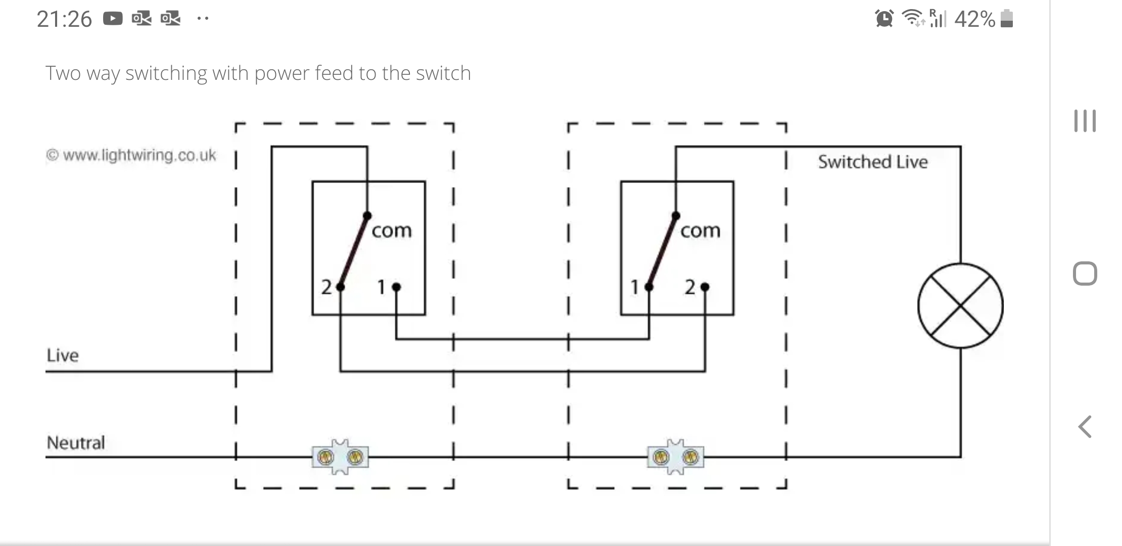

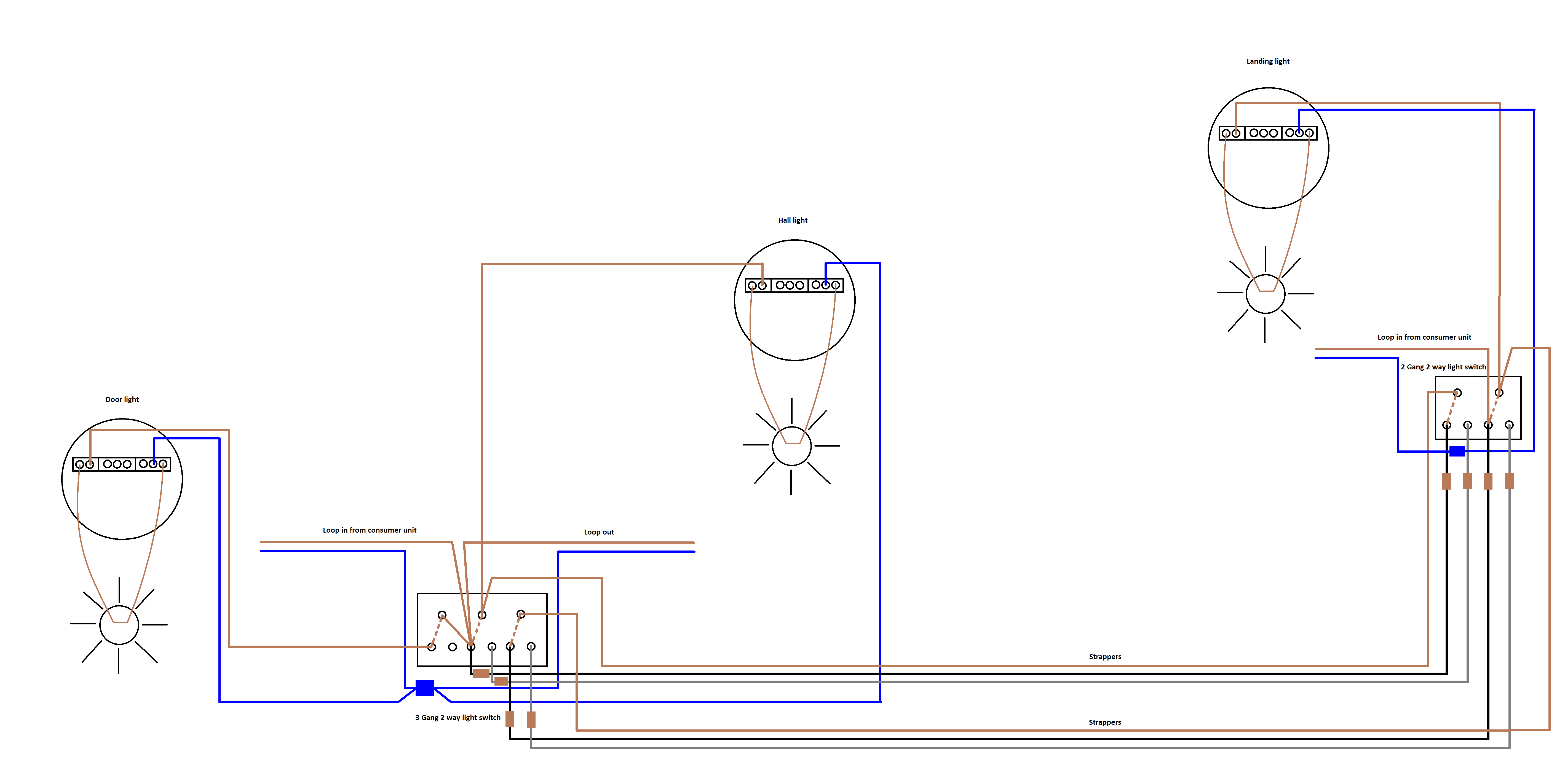

Ok i'm on holiday & im still checking this forum lol
Here's my attempt using Microsoft Paint
Not a bad effort and for a slightly different question it would be the perfect answer... but read the cable purposes again carefully. The cables in the OP are the only ones involved.
[automerge]1569696958[/automerge]
In fact, I think @Loki it's my fault. I've just re-read my OP... I should have made it clear that the cables I've listed are all at the switches.

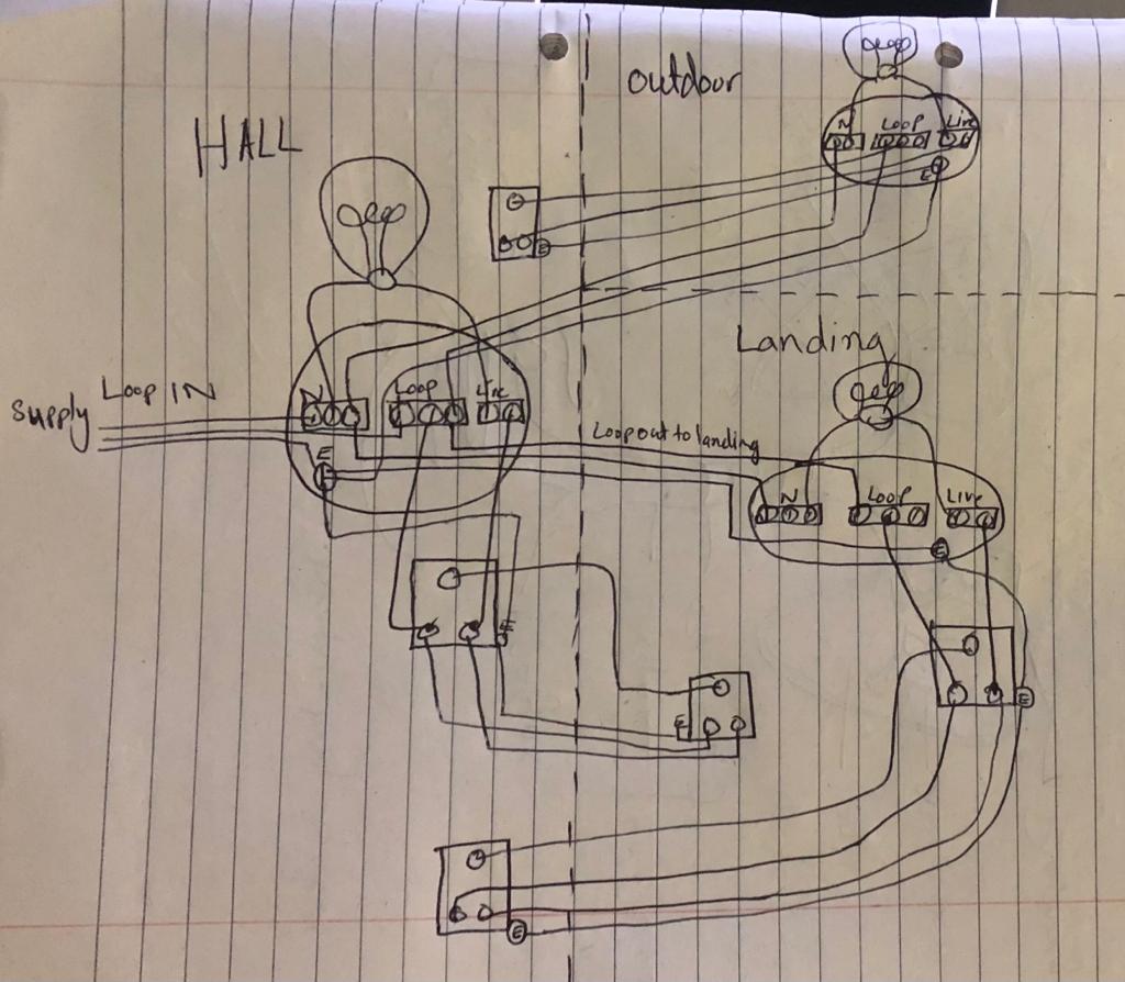

I tried the ‘spoiler alert’ thingy. However I think a few too many drinkies affected the process ?

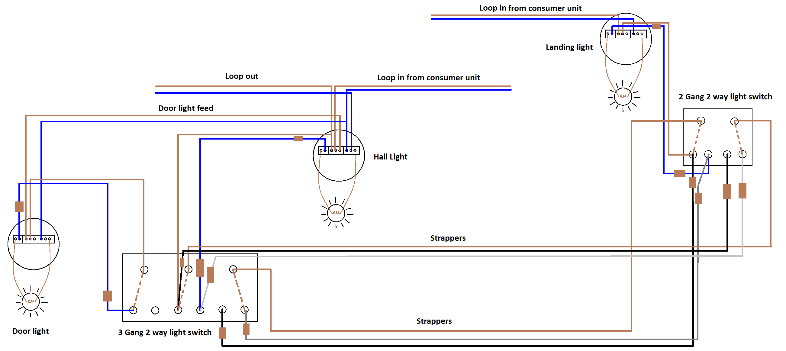

Ok so I've redone it again this time switch fed :)
[ElectriciansForums.net] Little Wiring Brain Teaser
Better, but you've cheated :) There is no loop at the landing switch. I'm evil like that (actually just didn't want to run a loop into the landing switch) :D
However, unless I'm much mistaken, your two way switching won't work in this version. For the general case (the hall light) you had it spot on in your first attempt.

So this diagram is basically the solution to the landing light. I elected not to feed the landing from the upstairs lights for two reasons:- 1) I've done it before and I'm not keen on the fact you have to isolate two circuits to fully isolate the two switches and 2) because in this instance I didn't want to touch the upstairs lighting circuit (it's a full rewire except that one circuit - accessing it is difficult without significant damage to the building fabric and it tests OK).
I could be wrong with my statement about the two way in your second version not working, but I drew it out and I can't see how it works.
