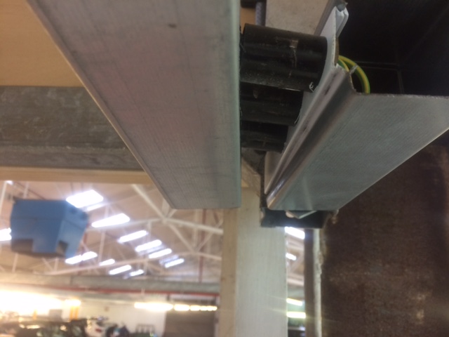

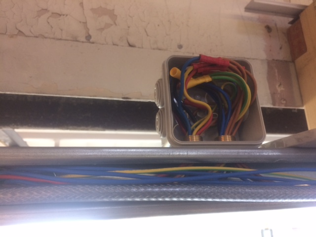

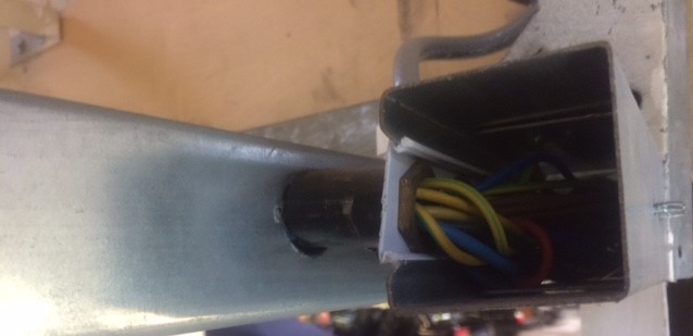

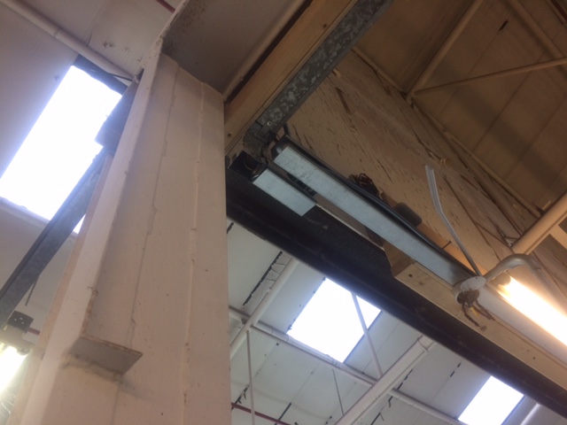

I'll go along with that... an example of altered trunking system to facilitate the installation of a car ramp....
View attachment 40189 View attachment 40190 View attachment 40191 View attachment 40192
Yep,excellent pictures,of what some of us have encountered,a hundred times. No saying that the test readings would not be acceptable,but an EICR is about more than mere readings,an estimation of function,under conditions not present,or that cannot be simulated,is also required.
