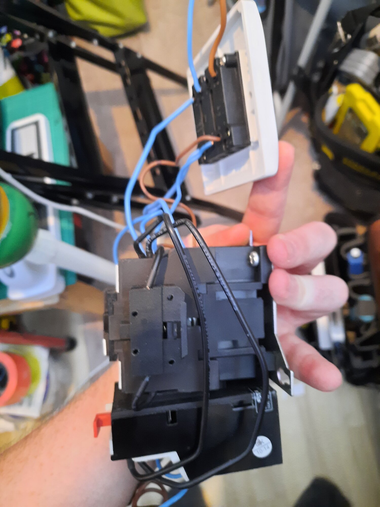

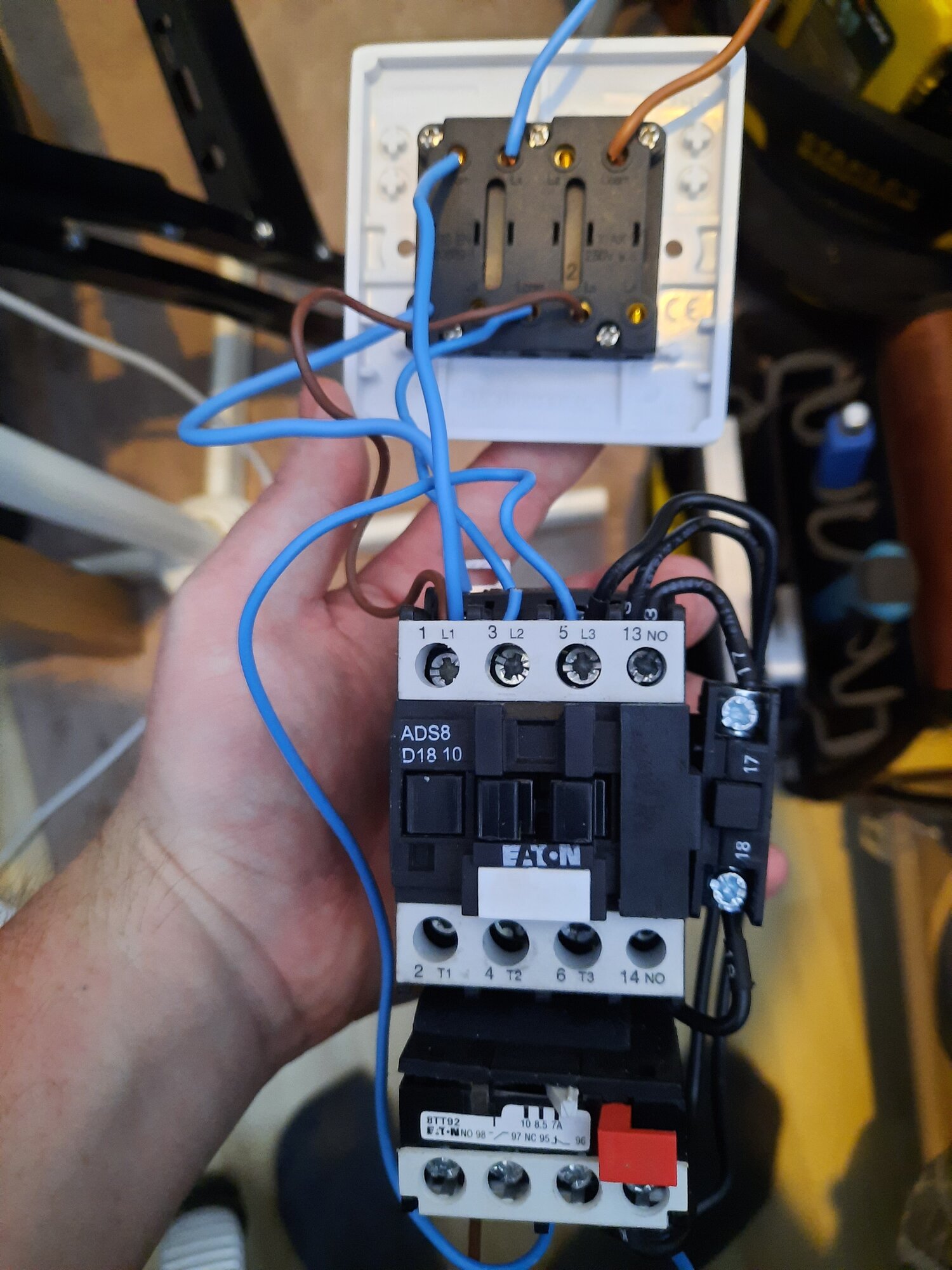

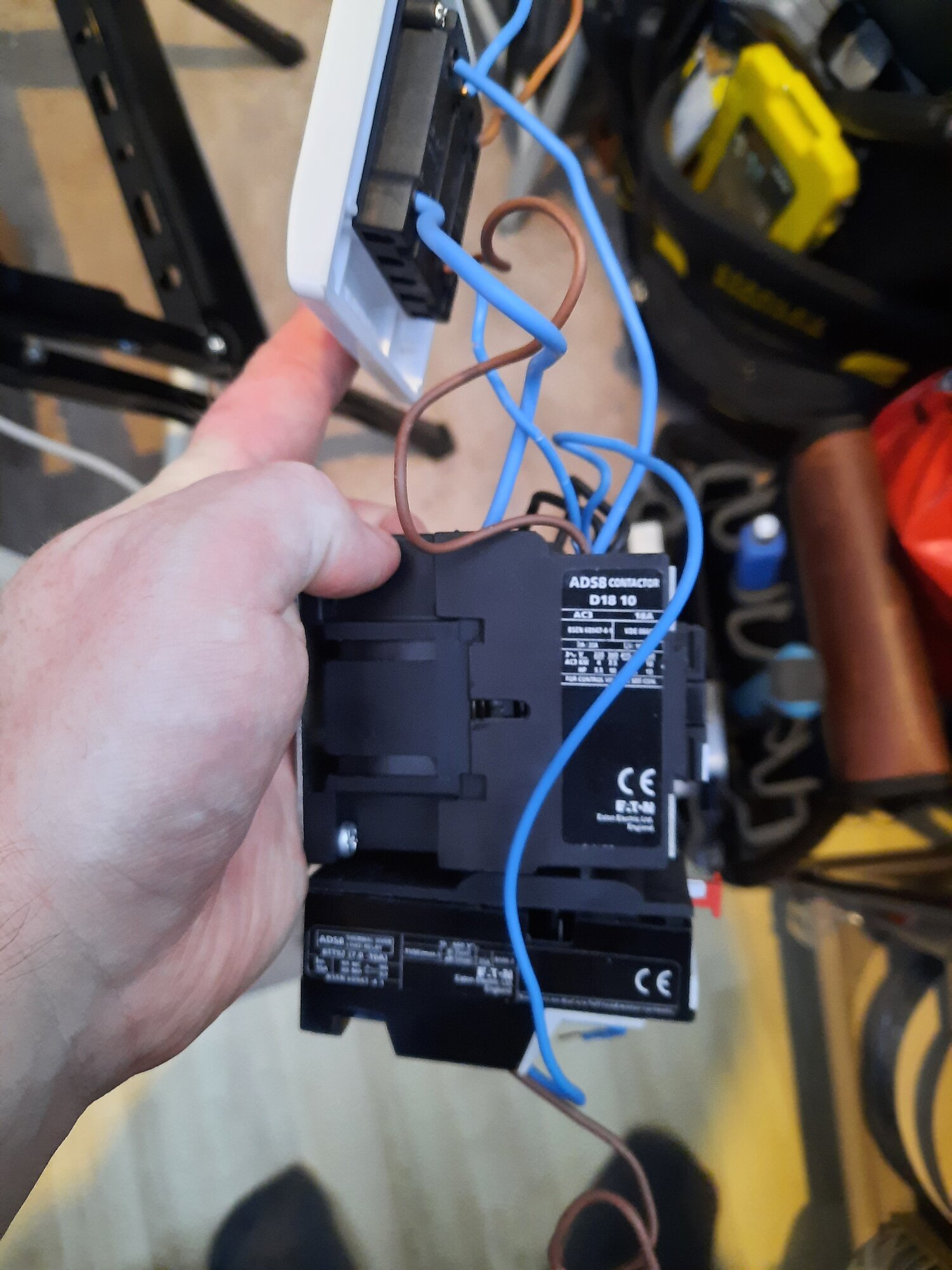

Hi all. I'm looking to build myself a rig with a small single phase motor and learn a bit more about motor controls etc. I mostly do domestic and some commercial but haven't much experience with motor controls. I always looks at ways to improve myself and my electrical knowledge. Most DOL starters would be pre wired so i take it there wouldn't be much to be gained from that. So would i be better buying NO & NC Switches, Contactor and overload and building it that way? Also looking for advice with regards to contacts 97/98 on the overload. Again, this is not a job or anything like that, this is solely for the purpose of building a rig to give me a better understanding. Any guidance and advice would be very much appreciated. Thanks
I've got a DOL on my rig, next to it is a 3 way 1G switch that will make/break the main live to the motor (1), the neutral (3) or thr hold contact (1-A1).
I get tothe wife to choose a setting and cover the switch, I then troubleshoot it and confirm that I have got the right fault.
Could you take some pictures of how you've wired that please?
