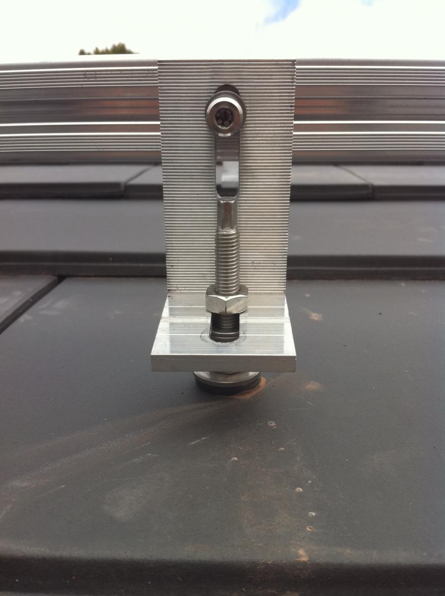

I was working with a full time PV roofer who says thier company uses the post type mounts on nearly all roof types now, including slates, drill a hole through slate or pantile with masonary sds, drilll a pilot into rafter with auger bit then screw post in putting some roofing mastic around rubber seal for extra measure. It sounded a lot easier than I am sure it is in practice, would need precise measuring for a start to hit rafter each time.

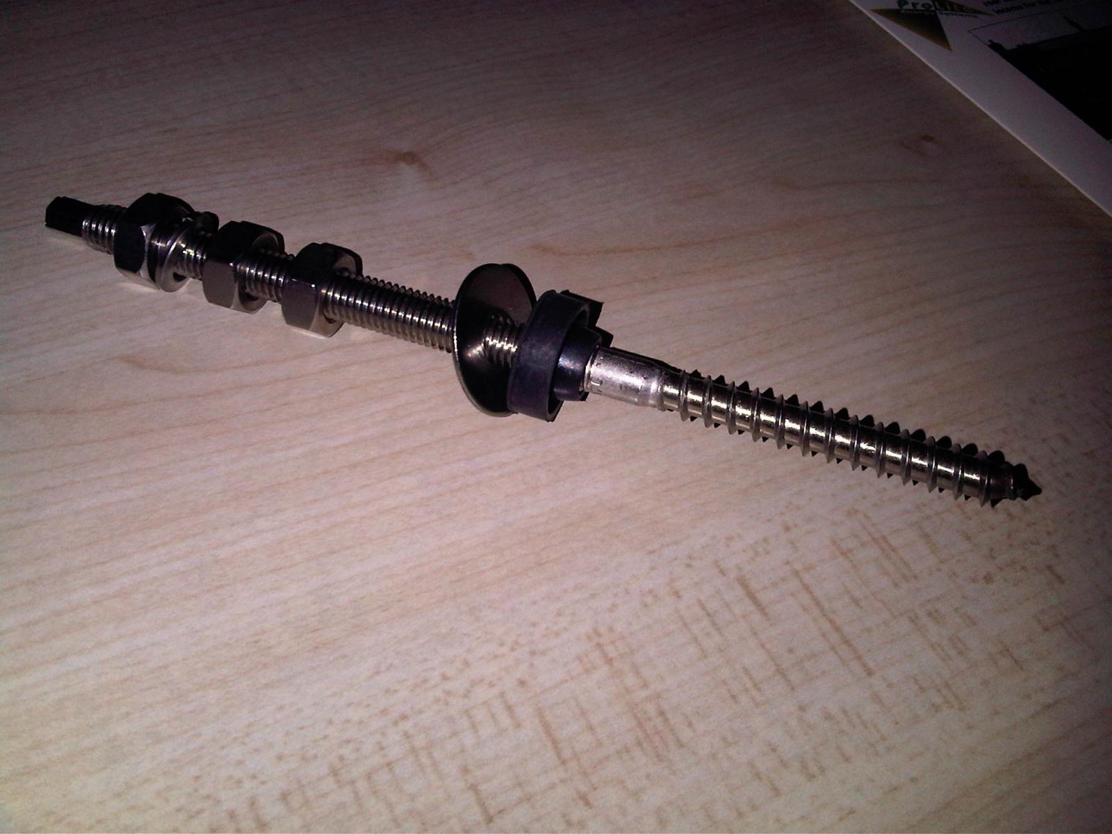

I have worked on many slate rooves and the best way I have found is to use what's called a hanger bolt. I start by drilling a small pilot hole from the inside through the joist and through the slate (that way you are sure not to miss the joist from the outside). I then get up on the roof and drill the hanger bolt into the joist. The hanger bolt has a small rubber gland which fits nicely into the hole you have made making it water tight.

we've used same hanger bolt system on several slate roofs it is an approved method and the washers are epdm rubber same as these rubber roof coverings which have long lifespans
one of our competitors has mentioned to several prospective customers that drilling the slates and fixing thru is bad practice but we've looked into it in depth and its an acceptable method and on some older uneven slate roofs its the only realistic option

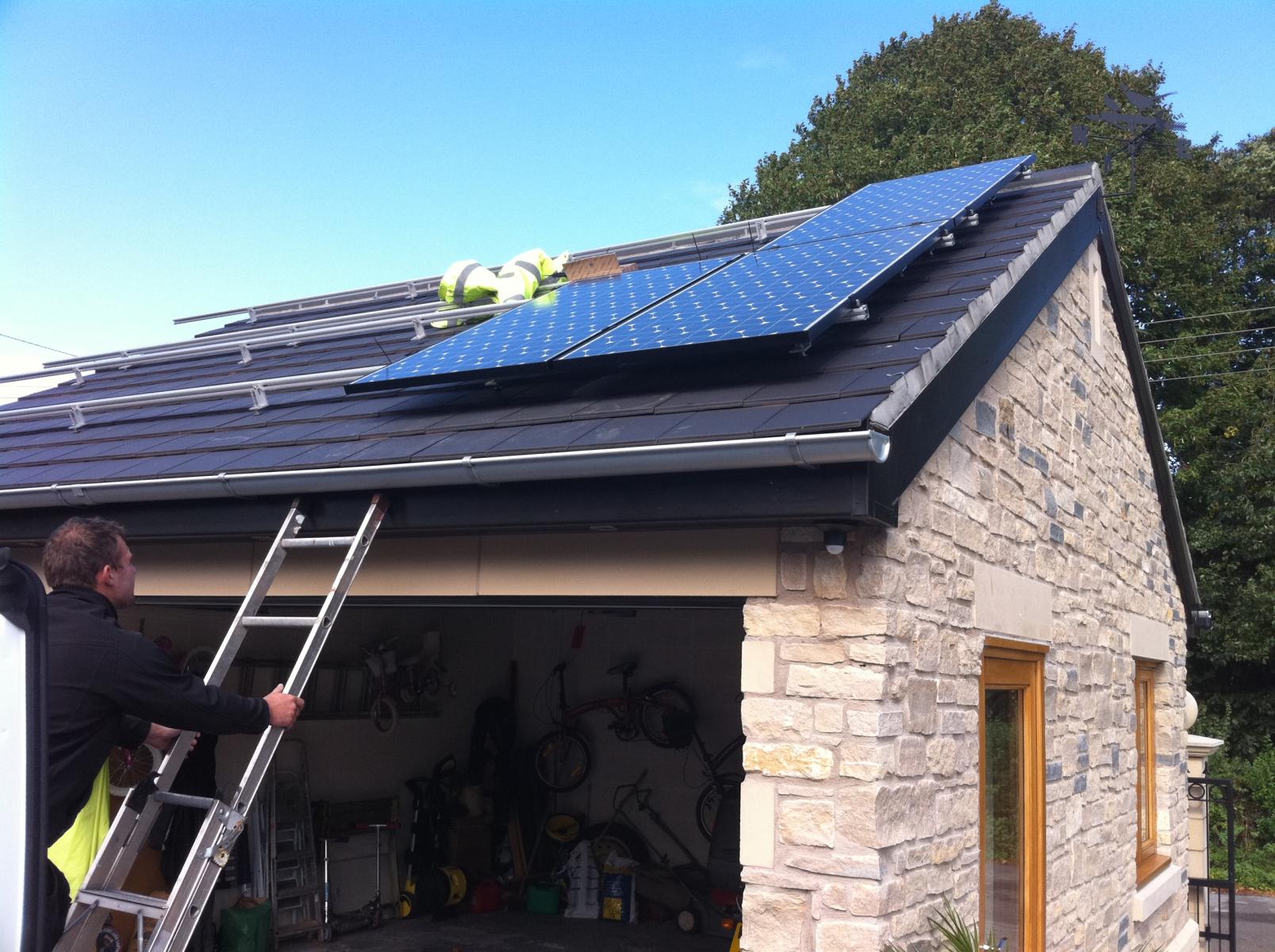

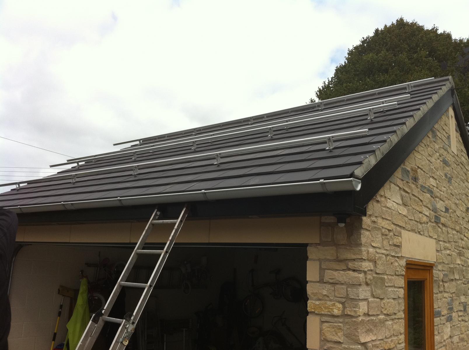

Tell me this does not look good! One of my installs! :D
