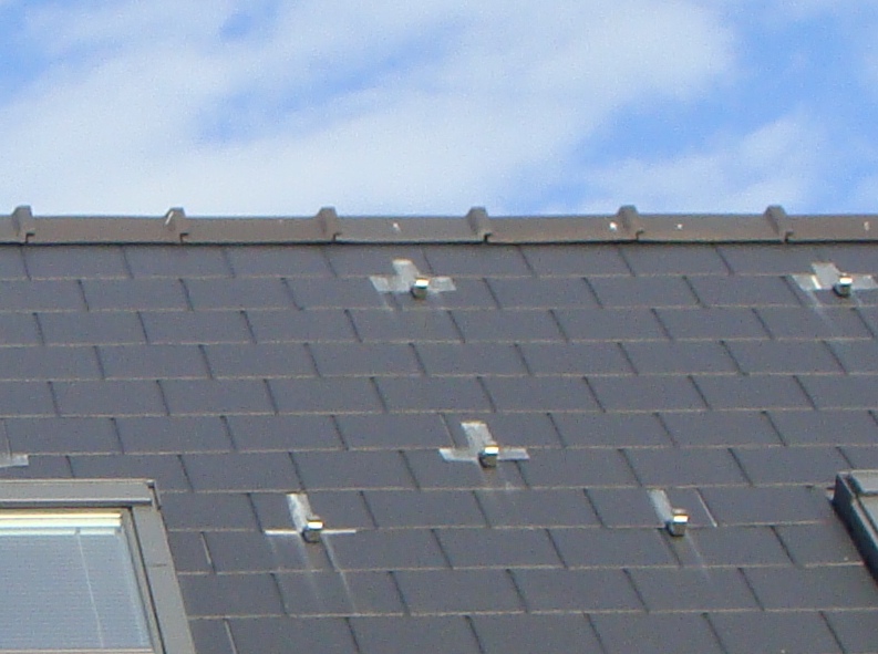

First post here - i cam accross this thread as im still not comfortuble with slate, ive done a slate roof and my way of doing it was drilling through and coach bolting an aluminium bracket with lead flashing over. I watch another companys website as they post photos each week of there jobs and on the last one it was slate and it looks like they use a pantile bracket bolted to the rafter and flashed over, they must cut the slate to fit.
Welsh slate & yorkshire stone. The best way is inroof strip it and fit it but thats because i like the roofing aspect and that when i walk away from the install i know there will be no leaks in years to come and dont mention sealants on roofs as they dont work. If you need to use sealant you have not installed the gromit properly and it will leak in the future but if the anchor bolt is installed properly square of the slate and tightened down properly it will be ok. Thin brittle slate - you are better using the in roof kit but that could make you less competitive so back to plain tile brackets, lead flashed in and slate cut to suit.can give you pictures to see what you think just drop a line
I drill a pilot hole with a 2mm drill bit and from the outside drill the hanger bolt into the joist!
I think this is a great idea for locating the position of the bolt. But one thing is confusing me....Do you drill squarely through the entire depth of the joist (4 inches, say) and then through the slate, or in through the side of the joist at an angle? It seems that you'd need a very long drill bit to drill squarely up through the joist and 2mm is a bit thin. Anyone got any ideas?

There is no need for lead on a slate roof if you do it properly, position the right brackets correctly and you'll be able to cut them perfectly to make a weathertight seal that is almost invisible. When I get a chance I'll photograph the process. It's a bit like one of those ornamental puzzles but when you get it then it's easy!
Hanger bolts excerpt pressure down on the slate to make the seal. slates are very weak in that plane and will crack, if not immediately then at some point down the line. Hanger bolts are for tin roofs! I wouldn't want to be one of those installers who's put loads of systems up with hanger bolts, time to close the company and re-open with a different MCS or you'll catch the warranty claims further down the line.

I use a thick aluminium roof anchor, fix the anchor flat to the top of the slate over a rafter carefully drilling through the slate with a masonry bit with the hammer drill-action turned off (like you would a ceramic tile). Sandwich a flash-band pad between the slate and the anchor and use lots of roofing sealant (from the roofing supplier) Use your favourite coach bolts and don’t over tighten. It helps to make your cable entry first then you can measure off from the inside and find the rafters from the outside. You’ll defiantly need a slate ripper, to replace Brocken tiles and you’ll need at least two good roofing ladders which you may have to modify with extra padding to protect the sates.

I have pictures if you're really interested, I live on the Dartmoor national park all the local installs are on slate roofs. It's a really unpleasant task but it works a lot better than you would imagine. We’ve never had trouble with leaks on slate installations because they’re so much easier to seal up.... You can still give me a tiled bungalow any day !! :)
We're in a national park too, on slate roofs - agree with you about the tiled bungalows, urban installers don't know they're born ;-). Our roofer just takes the slate out fixes the hook and flashes it all back in with lead. None of it a problem just more time consuming and a bit of extra cost for lead and replacement slates. The only problem we've had was with cambrian slate which gave us problems with the hooks and flashing it back in. I wouldn't expect you to be having problems with leaking after such a short period, it's after a few years of the slate moving with the wind that the leaks wil appear and need to be resolved. None of our customers would let us near their homes if we were drilling through the slate.
