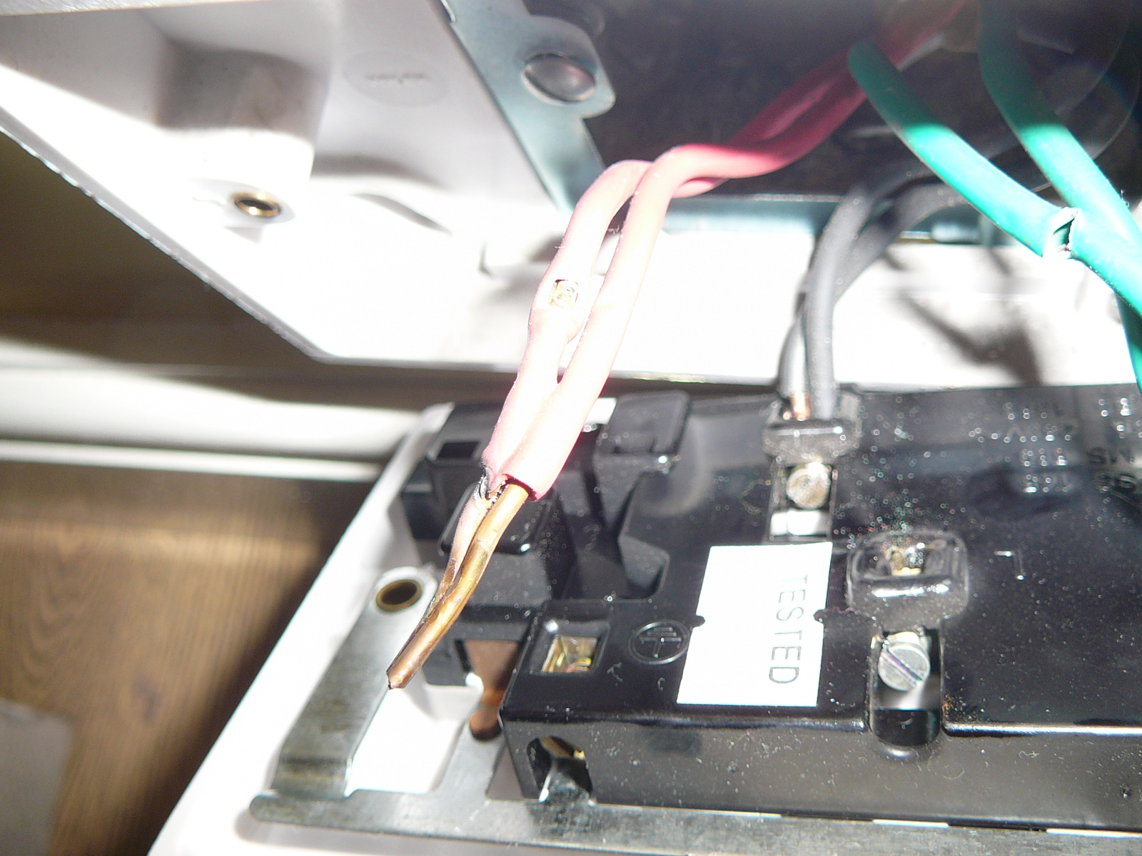

The house I have moved into is a nightmare, I thought isolating the lethal external wiring would do the trick but today I was stupid enough to start inspecting some suspicious power sockets around the house.........Ohh myyy
The first delight was a mystery spur fuse turned on but what did it power ? well it seemed nothing, on further investigation the spur it fed in 2.5mm disappeared into the wall behind the back box and upon pulling came free with a cut-off end!!
[ElectriciansForums.net] Moved house into a disaster zone

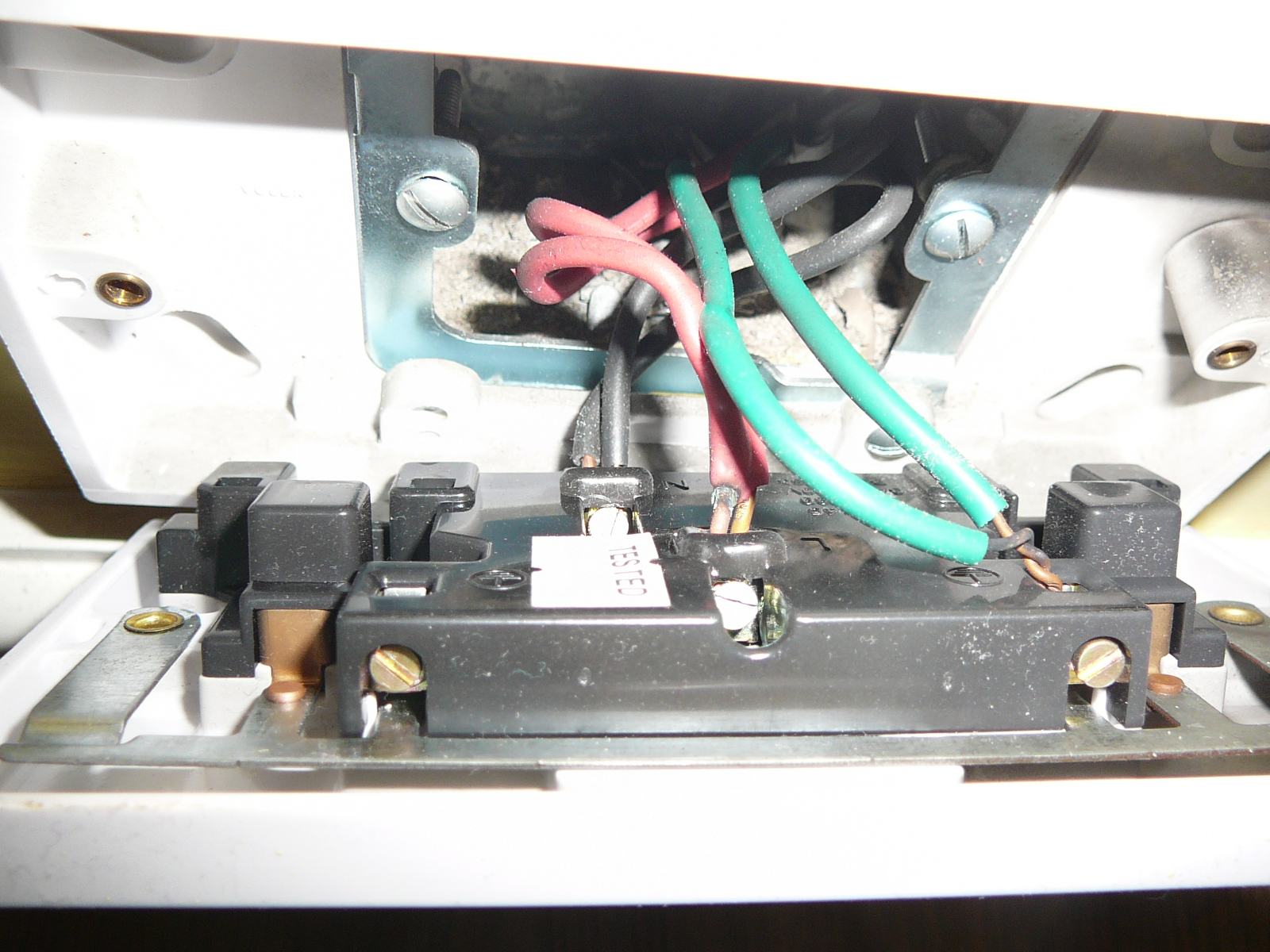

As I continued I kept finding loose screws resulting in wires pulling free from the sockets (not sure about TV antenna in same back box behind blank plate either)

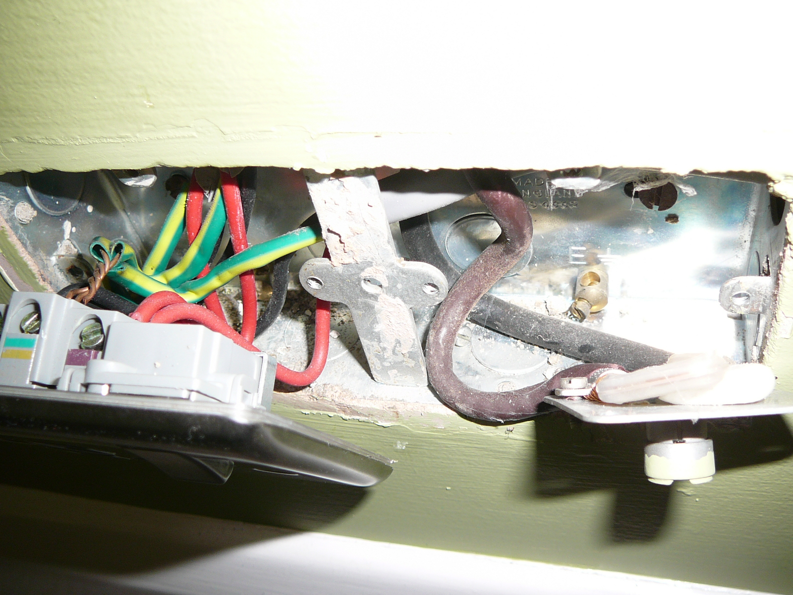

As I progressed along the loose screw brigade things got more serious, here we have a Neutral ring break
And then the worst uncovered so far a high resistance arcing live ring break that has melted the insulation, made contact with the earth and blown it in half resulting in an earth ring break also

Needless to say the damaged socket was replaced. I have many more disasters found and undoubtedly given the quality of what I have found so far more to come. My most serious worry is loose terminals in junction boxes under the floors (there are many spurs with no apparent source) that are now unfortunately covered with wretched laminate flooring over the floorboards.
I will add further horrors for those who can stand it!
That is rough as a badger's gluteus maximus.
It is the sort of thing that cries out for a rewire just because you can't trust any hidden stuff. At least with a RFC you can get an idea if the links are all low-R, but not the many other routes to failure. Any photos of the CU with cover off? (Power off first, obviously!)

Seeing these pictures after the other post, at least it looks like the cabling visible isn't the nasty VIR stuff - more likely 60s-70s, which may have some life in it if properly installed - though a rewire should probably in the not too distant agenda.
Does sound like it needs a proper EICR to work out what can and can't be kept though. There would be no point in putting an RCD on any of that installation without a thorough test as the chances are it would just trip constantly....
