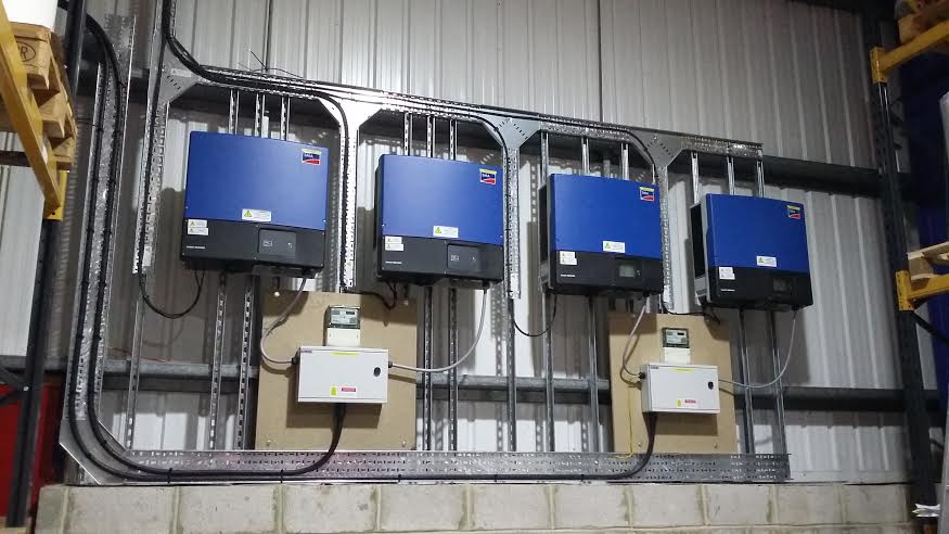

Seen as this thread has become a bit of a "bitch fight" in regards of other members installs. I'll post this one up for you all to get your teeth into. No holds barred, say what you want, any pointers that you post up will be taken in good spirit and as an education from the more experienced members. (ps the grey 5 core 10mm yy cables were tied up or banded after the photo was taken).

All done from scaffold btw with a really nasty boss that makes me work over Xmas and New Years (cough cough.... get your own back later :wink: )

nice job Paul. How comes there is 2 generation meters?

Customer change his mind whilst panels were being installed and went for the Bigger install. MPAN already sorted for the 2 x 25Kw inverters, another 2 x 20Kw needed to be added. The FITS payments timescale has thrown everything up in the air these past few months. God knows how the lads in the office and designers have dealt with it.

Proteus boards!
The SWAs are evenly spaced on the vertical then bunched together on the horizontal, I can see why but it would bug the hell out of me.
Proteus, yes I know :smartass: but you can only play with the cards you are given. ps dont every try to do a central entry with swa, the busbar is in the way and you will only get frustrated trying to terminate the 25mm. Bad design imho.

Of course its badly designed, its proteus.
O wasnt thinking about grouping, just pure aesthetics.

On the Ac side does it need 4 pole isolation ?
Also as good as sunny boys are I don't like the built in dc disconnect and would also prefer an obvious iso up front just for isolation.
Good question, 4 pole AC Iso at the DB within reach and the DC Iso is on the inverter and labeled up. There is also DC Iso fused units on the roof.
Plus (down stream) there is 2 x 100A 1361 3ph fused Iso switches going into the main DB and then protected by a 200A 60947... Plenty of protection, just a pain putting labels on every bloody box in the transformer room/plant room lol.
