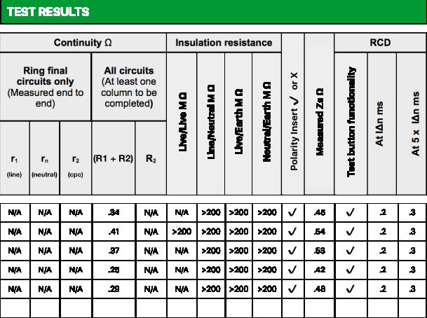

Hi Pete999, here is a partial screenshot of a page of the doc.
The only one i can see on the report just above the testing schedule info I sent, Measured Ze: 0.65. The other parameters you describe are not included on the report that i can see, other than on the testing schedule info I already uploaded. What I mean is there isn't any box into which any of these test values could be written, unless I'm just overlooking them. Are you sure that this particular form requires a test result rather than just confirmation that a test was or was not done? I can't see any boxes for these values, it's not that the electrician has left them empty.
Other values I can see:
Nominal frequency: 50Hz
External earth fault loop impedence Ze (2/3): 0.57
Prospective fault current (2/3): 0.5
the report also states that he used for testing equipment, a Kewtech KT64 (might be 84, hard to read)
When changing a consumer unit I would expect to test and record R1+R2 values for radial circuits, r1, rn, r2 and R1+R2 values for ring final circuits. Insulation resistance for each circuit. Zs for each circuit and RCD trip times for each RCD/RCBO on the board.
These prove continuity of the protective conductors on the circuit (R1+R2) and go a long way to proving the correct polarity of the circuits, end to end continuity of ring final circuits (r1, rn and r2), give an indication of the condition of the cables and demonstrate there is nothing on the fixed install that might trip the RCDs (IR), demonstrate that the circuit can meet the requirements to achieve the maximum disconnection times required by BS7671 (Zs) and that the RCDs will operate in a manner that should save your life (RCD trip times).
Without these tests you can't say the installation is safe and in my opinion, he should not really have signed it off.

I would be very surprised if the RCD trip times were .2ms and .3ms as those results suggest. Especially as it appears the result show 5 circuits, but there appear to be 6 in the board spread equally across 2 RCDs.
Vol, do you have a snap shot of the 'Circuit Details' and the 'Test Instrument Used'?

The consumer unit is a 11 way,the test schedule lists 5 ways,the 2 Rcds seem to have 3 circuits each ,decisions,decisions,try as I will,I just can't make sense of what has been produced
Is that right a measured ze of 0.65 ohms?
The zs results are less than the ze?

Supposed he must have measured zs rather than the calculation as the zs readings would be higher with the calculation.
I've never got rcd test results that low haha
0.02 and 0.03 of a second
Edit
Or is it 0.2 and 0.3 of a second I can't make it out?

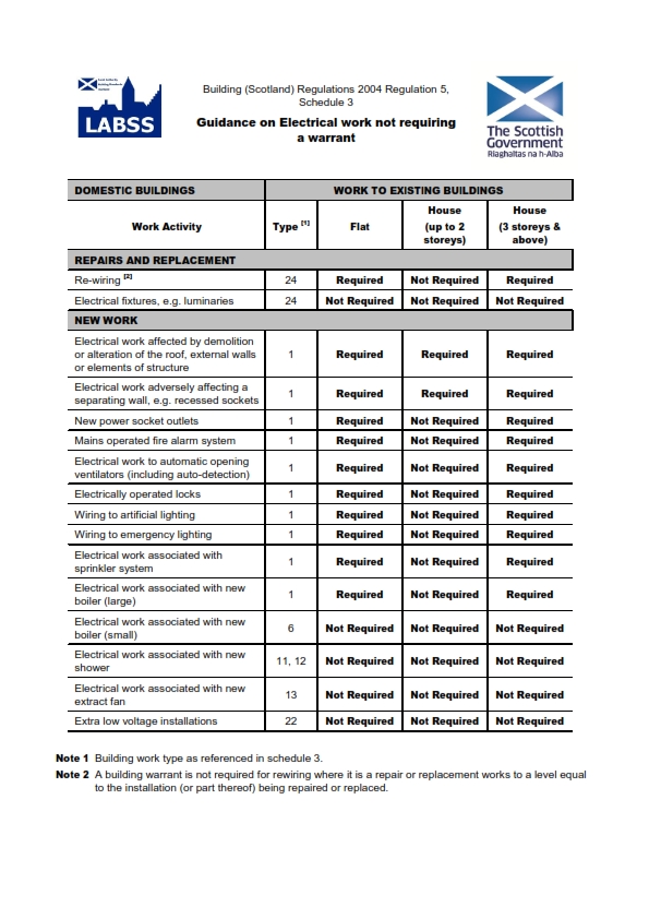

Did you find out about the Building Warrants?
