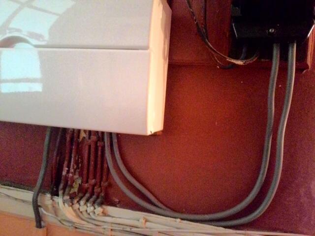

I promised an update to the saga. The electrician came this morning and within 10 minutes had established that the meter tails were installed incorrectly (ie reversed). He kicked himself for not having checked for polarity reversal prior to the CU installation and he maintains that he reinserted the tails as they were oriented in the previous fuse box. But he refused to insist that was the case accepting that he may have inadvertently made the mistake and was much humbled and chastened that either he caused it and/or he left it that way (whoever caused it originally). As soon as the tails were swapped my wee socket tester responded well with three lights flashing! The electrician used a number of different testing devices.
For the next few hours there was a lot of testing and form filling.
The form was completed on his tablet and he emailed it to me before he left: It is a Domestic Electrical Installation Certificate (Requirements for Electrical Installations - BS7671 Wiring Regulations). A 6 page document with lots of details which I will peruse thoroughly when I have more time.
The electrician apologised profusely for his errors of testing and not paying sufficient significance to the L&N reversal.
I got to look in the open CU while the electrician was here this morning and I took a photo of his work. A snap of the meter tails and some surface wiring is shown too.
As far as I am concerned the problem has been resolved for now though I am still planning to have a complete EICR done in the near future.
thanks for the update. however, being picky, i can see 3 possible issues with how he's left it now. i stress that these are in no way dangerous at present, but could cause problems in the future.
1. the tails entering the CU appear to be hard up against the metalwork. where's the grommet?
2. the tails from the meter should be restrained with cleats to prevent them being tugged and putting a strain on the terminals.
3. why are there 3 or 4 cables in the no.3 breaker when there are spare ways?
Hard to see but I hope he used grommet strip where cables enter the back of the consumer unit.
Vol we are picky buggers at times but at least the electrician admitted he should have checked and no harm came of it.
Thanks telectrix. Let me answer to the best of my ability:
1. it's a bit difficult to see but if you look really hard (at the bottom right of the CU in the photo) you can see that the CU is mounted on a wooden panel. The tails actually go up behind the wooden panel which is raised from the wall on two battens.
2. Fair point, Will be attended to next time an electrician comes in (won't be long!)
3. This was left by agreement but is part of a future plan. The house wiring is a bit all over the place (thus the pleasant mild surprise when the RCDs worked first time of asking) and it would have been a much bigger and different job to balance the various circuits across the board. So this job was just to swap to the CU as was: tThe CBs were designated on the panel for the obvious zones they controlled. In addition, there is so much surface cabling with cables going all over the place to surface mounted outlets that I want to investigate exactly what CB controls which outlet. Scaredy cat I may be but I wasn't prepared to do that while it was a traditional fuse box with old potentially disintegrating fuse wire holders!
Not an ideal situation but the balancing of the circuits will take place when the new kitchen circuit is put in soon and another electric shower too.

Here is another image showing the cables going up the rear of the wooden panel. I have no idea what the entry point of the tails to the CU actually is at the rear. However, the internal work done on the CU looks neat and "professional" so I'm going to assume that everything is OK with respect to the tails entering the CU.
