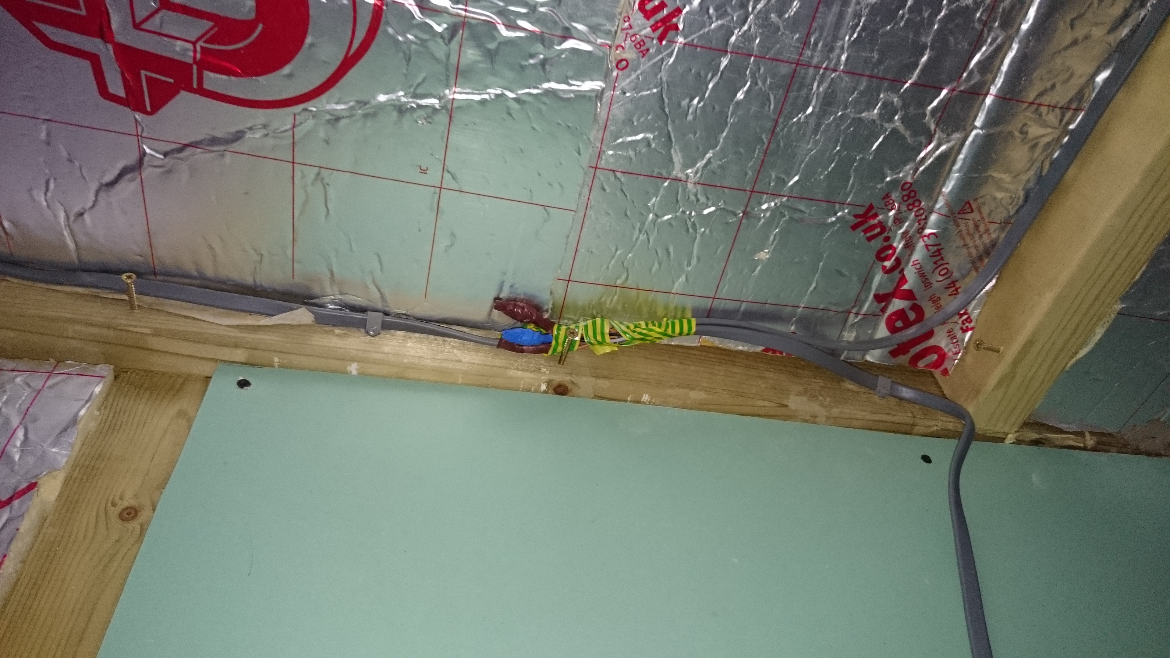

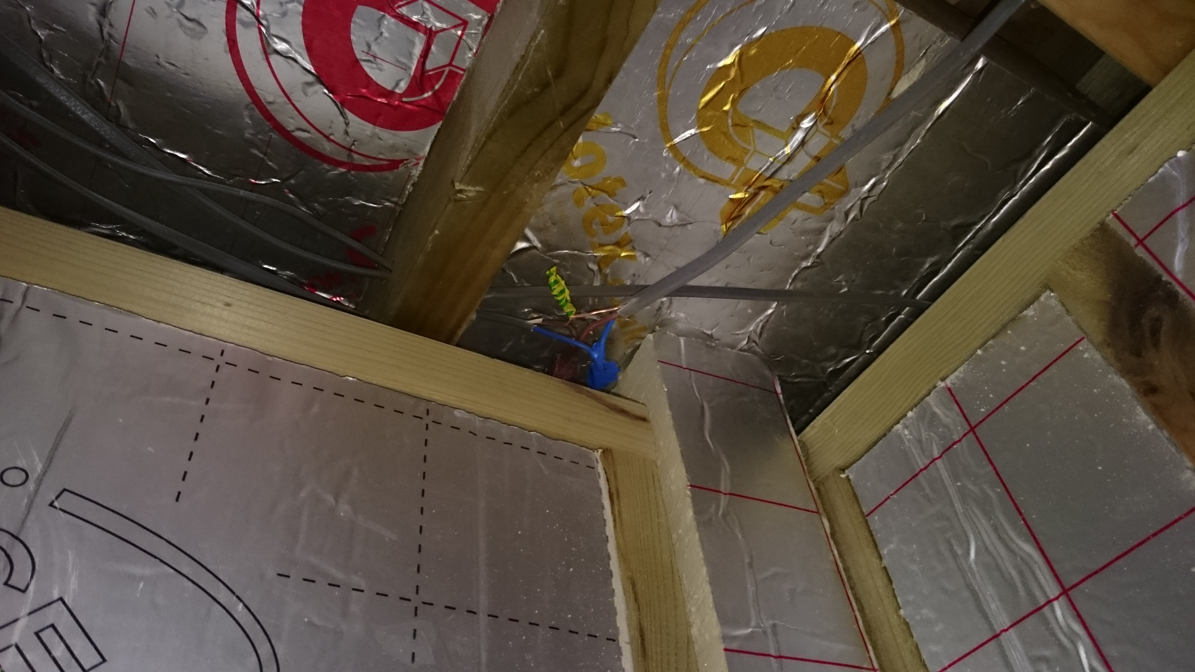

Hello,
I have an electrician installing a new light and ring circuit for a loft conversation. He has joined the cables using block connectors which are in turn covered with electrical tape. Some of the earth cables are exposed. Could someone please tel me if this meets UK regulations.
Kind regards
Asosoon.
P.S. I'm not an electrician.
Then they should be in an enclosure of some sort, and the earths should be sleeved for identification.
I'm sure this will be corrected if you ask.
If they are screw terminals then this joint in the cable needs to be also available for future inspection. If it will not be able to be accessed from below the ceiling then there must be access made to get to it from above. Either that or a different type of joint known as maintenance free will be required.
It's a loft conversion. Much like a kitchen fit,I find that the chances of an actual electrician being involved are dramatically reduced in these cases.
I would take a stab that these block connectors are used for spotlights with the cpcs floating about.
