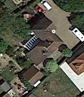

Hi all, I looking at having a new solar panel system installed in kent and would like some advice if you could spare some time.
I have been looking at getting installed around 6-8 kw system. If I go for an 8kw system I would have shading issues on a bottom row of panels (spaced over two roofs and detached garage roof).
I could go for a 6kw system (over one roof and detached garage roof)I wouldn’t have any shading issues or I could go for somewhere in-between.

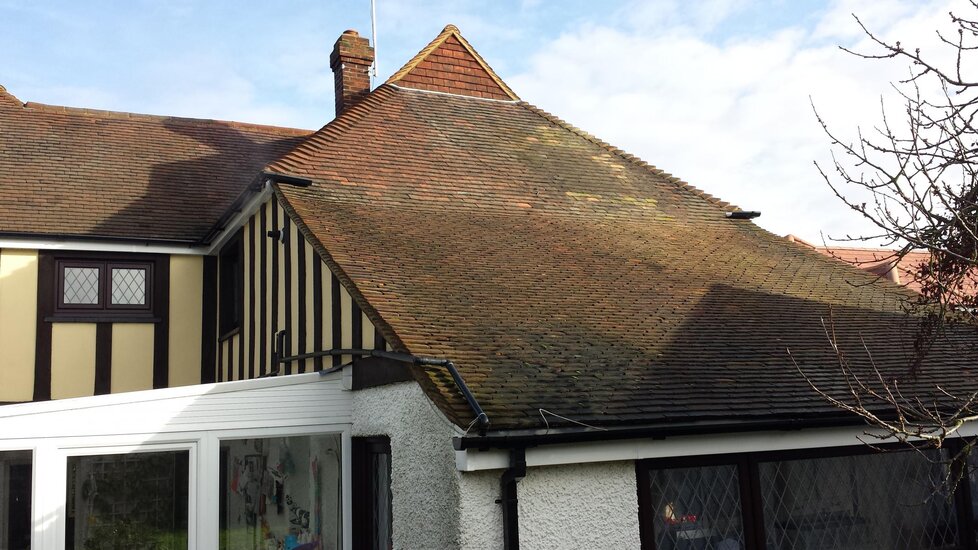

Without assessing the site, there is no way of knowing exactly how much of a shading issue you believe you have. Sometimes it is much less or much more severe than a customer realises.
Having shading doesn't mean you automatically need to have MI or optimisers. Get someone to come in and design you a system properly.
I won’t have any shading issues on the garage 3kw system.
The house will have shading issues (this time of year) if I use the on the long roof at the back (chimney on the back was removed last week), see attached photo taken at the weekend @11:45am
But won’t have any on the side of my the trees on that side are toy trees only 15ft high, but can only fit 2.5kw system.
I’m thinking that if I use the garage 3kw with string inverter in the garage. Use the side of the house 2.5kw and maybe the top of the back roof for another 1-1.5kw as it won’t have shading issues that high.
