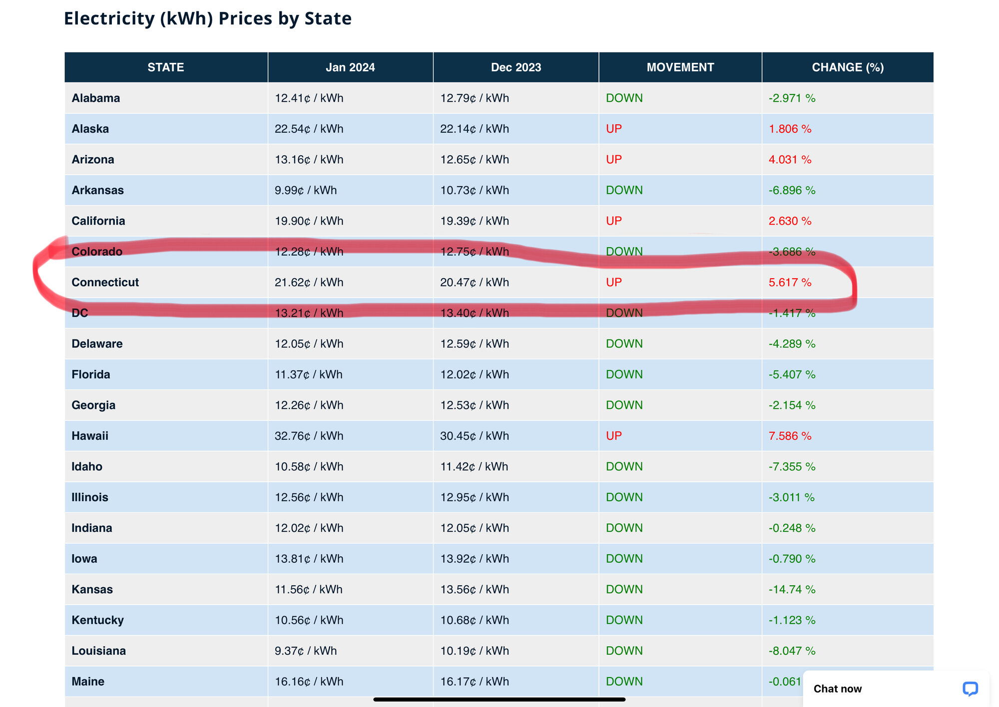

I will describe my problem in as much detail so you guys might be able to answer my question. I am never home, my Electric bill is $ 28 to $30 a month, has been that way for years.
I recently bought an E.V. so I had an E.V. Charger (Emporia is the brand) installed, hardwired by an Electrician. BTW, charger is set to 40 amps and I don't have breaker box I have fuse box, 50 amp fuses
The 1st month I used my charger 4 times from almost empty to a full charge. The bill was $128 and change, which tells me it cost about $25 per charge when it should cost about $9. My power company rates are
13.2 cents killowatt and Emporia charger will use some power if it is powered on with no use. Emporia told me a few dollars per year. Next I did not use my charger for a month just keeping charger power on. The bill was $ 48. just with charger power on. Finally
I removed fuse cutting all power off charger and the bill was the normal $ 30 and change. My only conclusion is that Charger is costing me about $18 a month just keeping it powered on, but not using it to charge car. Am I crazy? Can this be fixed?

Have the electrician measure the current being used to the EV.
The current rating of the charge point is largely irrelevant in terms of how much energy is consumed in charging the EV battery, the current rating merely determines how quickly it charges.
The vehicle in-car charger is around 80% efficient, so of you have a car battery of say 100kWhr - you will need to supply around 125kWhr (because of the 80% efficiency) - if it's half charged, around 60kWhr will be used to get it full.
If the charge point is consuming 18usd - at 13cents this would mean around 138kWhr consumption - 200 watts continuously - so would get rather warm.

Hey Julie, My car battery is 65w, at 40 amp takes my car about 6 hours to charge from very low miles to full, How much in your opinion should it cost me for a full charge. My numbers say about 9 dollars. My Emporia app that is set to the correct rate shows just under that amount.
I think you mean 65kWhr , but at 80% efficiency
65/.8 = 81.25kWhr
81.25kWhr x 0.13 usd = 10.56 usd
If the charger is 100% efficient
65kWhr x 0.13 usd = 8.45 usd
So somewhere between 8.45 and 10.56 usd depending upon the exact efficiency of your in-car charger and the state of charge.
(9usd would give an efficiency of circ 94% if there was no residual charge left in the battery prior to charging)
Here again my bill, average $30 a month all year round, using the charger 4 times total month was $128. Keeping the charger powered but no car charging was $48 for the month. loosely you could say it cost me $70 for the four charging times about $17 per charge. That is what I am trying to figure out. My Emporia charger should not drain all of the energy. Monday I will call my electrician, they might be able to measure it. Even if they do I will still have those high bills.
