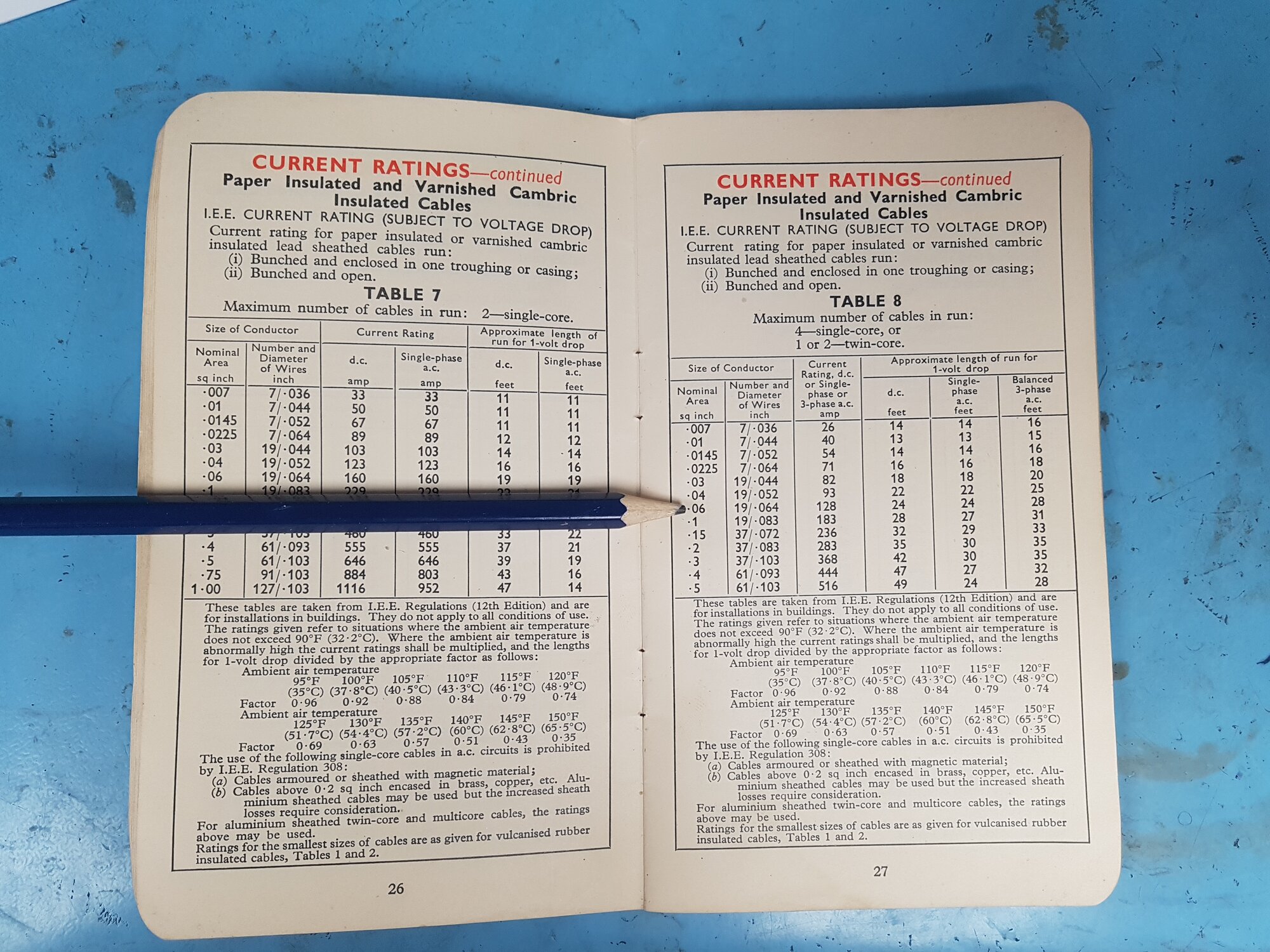

As I had to swing by the stores yesterday, I picked up some relevant info. There wasn't time to search for the books nearest to the date of your cable, as some of it is still boxed up from the move, so what I ended up with is all older than your assumed 1960s cable.
The first thing I noticed is the lack of 19/.103 conductors in the tables. There's 19/.101 hard-drawn copper but not annealed, so not relevant IMO, the largest 19-strand annealed conductor being 19/.083 at 0.1 sq. ins. So I think it is worth just double-checking your reference for the larger cable; i.e. where did the 95mm² and 19/something figures come from? Could it be a 0.15 sq. ins. cable of different stranding such as 37/.072?
Also, do you have the voltage rating or BS for the cables?
Looking only at the smaller cable for now:
BICC 'Cables & Tables' 1953 ed.
Quoting BS7 for 19/.064 annealed copper conductor at 20°C:
Standard resistance per 1000 yds. 0.4074Ω
Maximum for tinned conductors per 1000 yds. 0.4195Ω
Weight per 1000 yds: 720.3 lbs
Table 8, quoting IEE 12th ed, for one or two 2-core PILC 0.15 sq. ins. cable at 32°C ambient:
CCC: 128A DC or 1-phase AC
Voltage drop: one volt per 24 feet DC or 1-phase AC
No info on the lead sheath.

I didn't get round to the later Enfield 19/.064 cable yet, that is more likely to be of similar construction to your 1960s cable as they were probably both made to the later British Standard. The lead is significantly thinner so we should calculate that before making a final call on the sheath resistance.
Re the larger cable, I can't make sense of the '19/153' or '19/1.53' as given earlier.
  • 19/1.53 is a valid metric cable stranding for 35mm²
  • Trying to read it as an imperial size '19/.153' would make it 225mm²
  • My reference to 19/.103 was a top-of head attempt to match it to your comment that it was 95mm² equivalent. 19/.103 did exist as a stranding and is just over 95mm², but does not seem to have been used as a core of PILC.
  • 95mm² equivalent imperial size as a PILC core invariably seems to have been 37/.072
So we really need to clarify that number and gather any other possible information before we can make headway with the larger cable.
