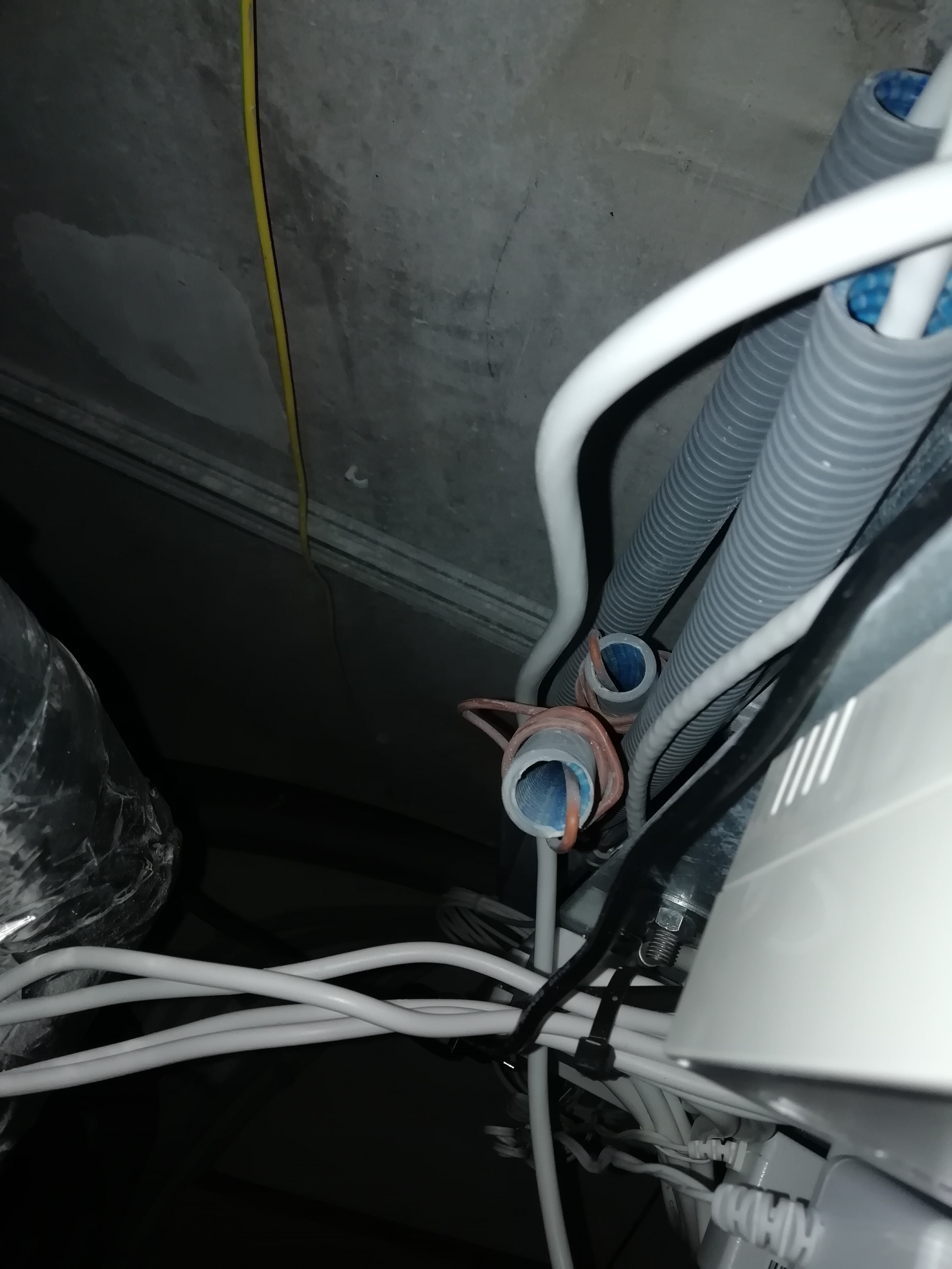

Looks like just a draw rope left in the pipe in the wall for pulling in any extra cables.
Do you know where the other end of the pipe is? It may just go down to a low level outlet, or one on the other side of the room?

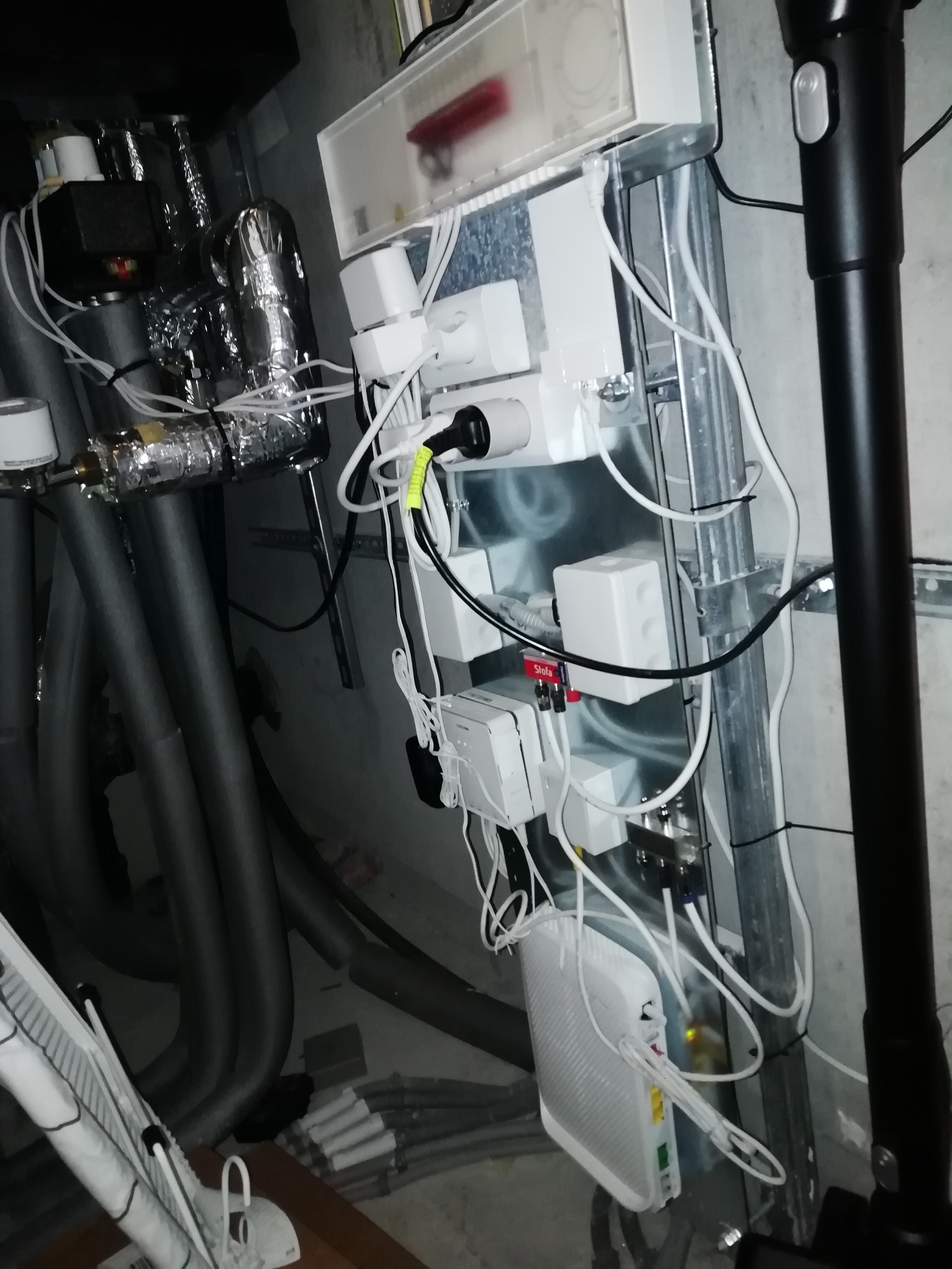

So i was looking if i can find where it is go, it seems that it is go in the "service room" . My question is why it is open like that? It could be that they let it like this for me as a owner to put in that 2 sokets what i want ethernet/tv cable/ power soket?

So i was looking if i can find where it is go, it seems that it is go in the "service room" . My question is why it is open like that? It could be that they let it like this for me as a owner to put in that 2 sokets what i want ethernet/tv cable/ power soket?View attachment 118074View attachment 118075
That is exactly why it is there, so a future upgrade to cable/ satalite tv or ethernet / phone line can be installed with relative ease.

Now that I have all this information, it makes sense why the outlet was opened. The location is in the bedroom. In the living room there is the same "style with 3 sockets" with power cable/ethernet/tv cable, alrerdy mounted.
