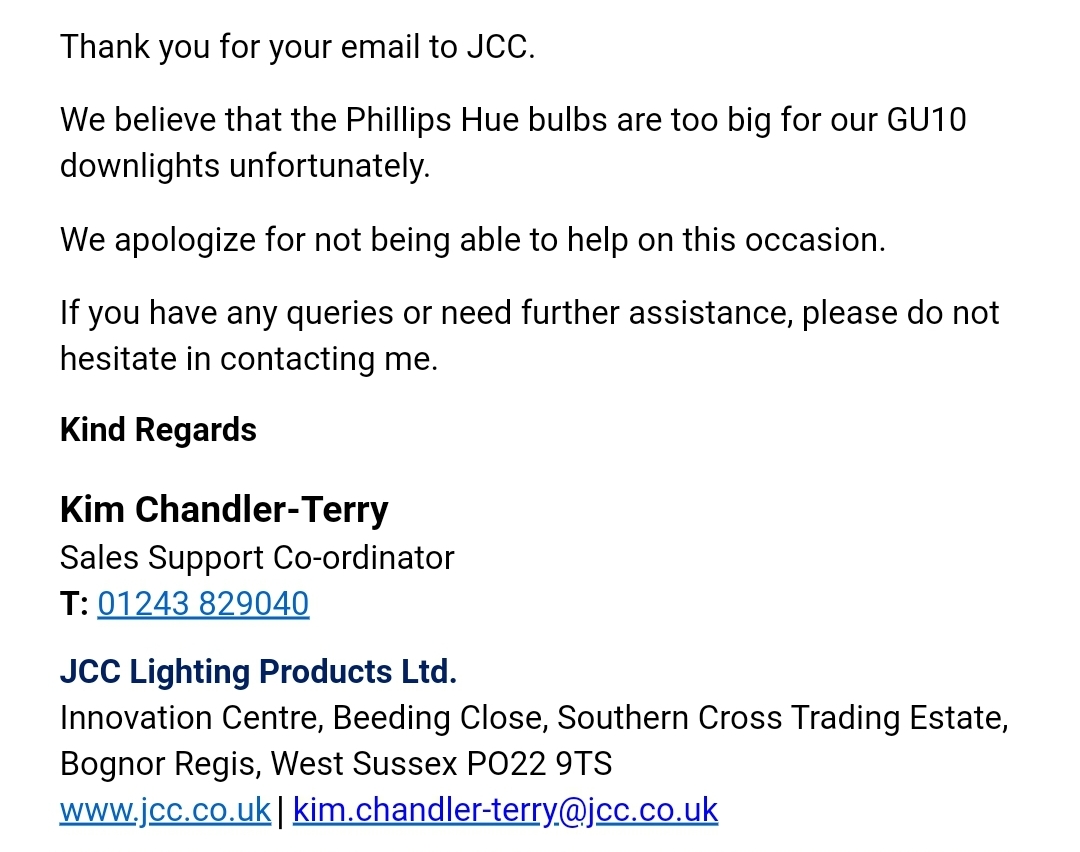

The sole thing steering me towards non integrated is that I've become from a place with a Philips Hue setup and just absolutely loved the functionality you get with those bulbs. Cheapest way to set scenes/light automation etc. 100% if that wasn't on my mind then these integrated LED units look far superior to what they were 10 years ago
