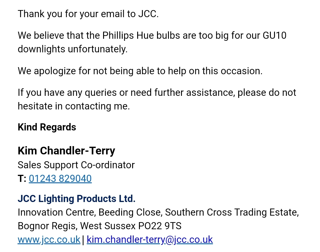

The sole thing steering me towards non integrated is that I've become from a place with a Philips Hue setup and just absolutely loved the functionality you get with those bulbs. Cheapest way to set scenes/light automation etc. 100% if that wasn't on my mind then these integrated LED units look far superior to what they were 10 years ago
Hi @Mjward
You may find some of the Philips Hue lamps don't fit in all downlights. I would recommend speaking with the manufcaturer first to confirm. Otherwise you could end up dissappointed.
All the best.
Ivan
It was indeed a very good tip, alas they do not fit
[ElectriciansForums.net] Preferred GU10 fitting?
Many thanks! Hopefully someone on here might have had success with them in a fitting too otherwise I'm going to have to give up my dreams of turning my house into a rave at the touch of a button ??

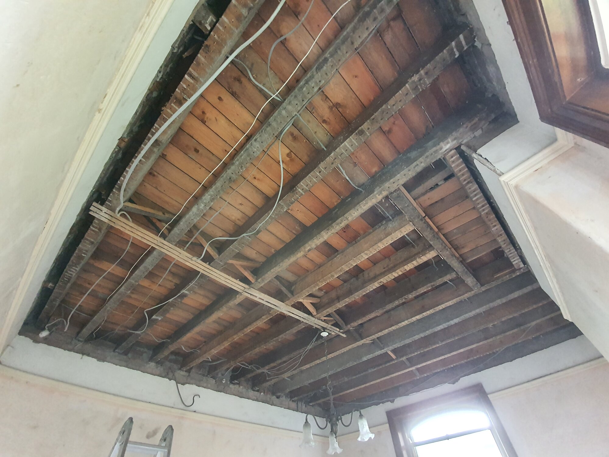

Ha priced to miss! Finally got all the lathe/plaster down in the first room and as per the theme with this place, it's covered with obselete wiring but think I've got most of it figured out now. With ceiling down will be considerably easier to run additional lights/sockets although main driver was for easier plumbing routes (switching from old school one way system to flow/return)
