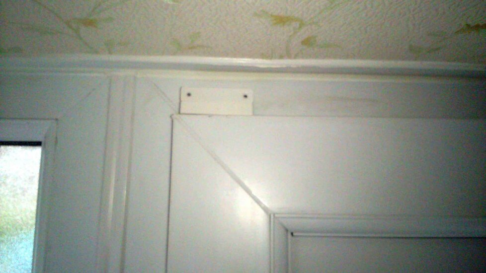

hold them together in the same position they would be on the door.
if you can feel the magnet pushing/pulling on the other one then it will be fine
thecontact allows a separation distance from magnet of up to 10mm. so a 5mm gap is ideal. going back to OP, fit like this, but with a clearance gap
[ElectriciansForums.net] PVC Door alarm contacts
a picture tells a thousand words, but it can't read!!!
could equally be fitted to side or at bottom of door. whatever makes the aesthetically most pleasing.
